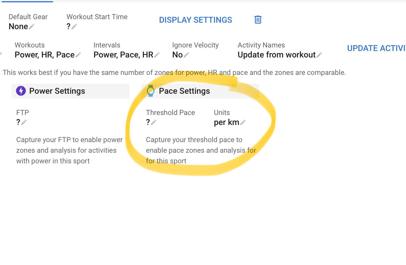

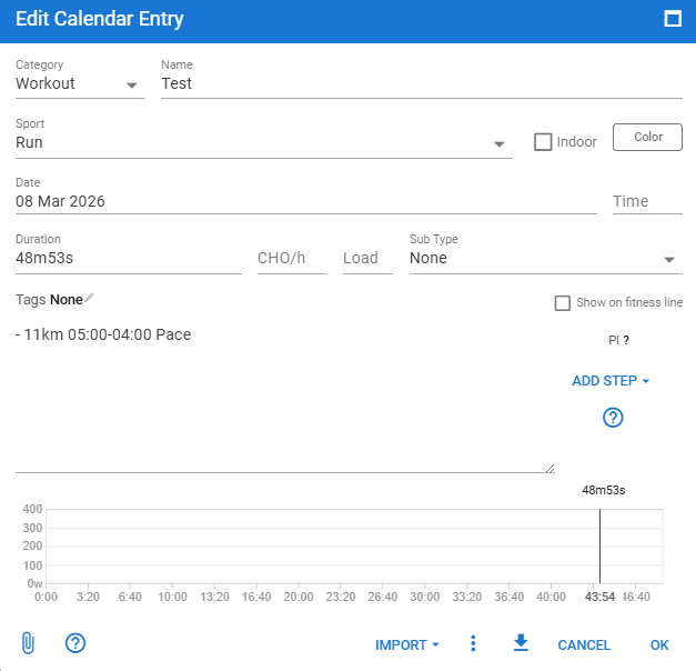

I dont get this. Even if I do as instructed, it still shows watts and only the km’s in my Garmin so I do not know how fast to run.
Are you sure you have any pace settings for Running?
This was it. Thanks!
