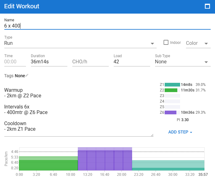

I’ve been using interval.icu’s workout builder to recreate Runna’s running workouts so I can do them in Zwift. They usually call for specific paces, like:
Or specific speeds:
It’s not terribly difficult to set this up in workout builder using percentages of threshold pace, but it takes a little trial and error to find the right percentage that matches the prescribed pace in Runna. Would it be possible to support min/km or kph (and their imperial equivalents) in the workout builder syntax? Ideally, I would like to build the workout in the screenshots as:
Warmup
- 1km Z1 Pace
- 60s 6kph
Main Set 3x
- 1.2km 4:50/km
- 120s 6kph
- 0.4km 4:25/km
- 60s 6kph
Cooldown
- 0.5km Z1 Pace
(Apologies if this has been asked before, I found a couple similar older threads but none that asked this specific question.)
