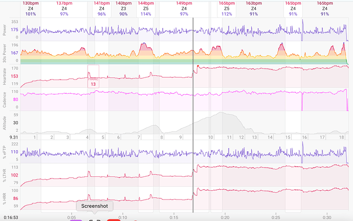

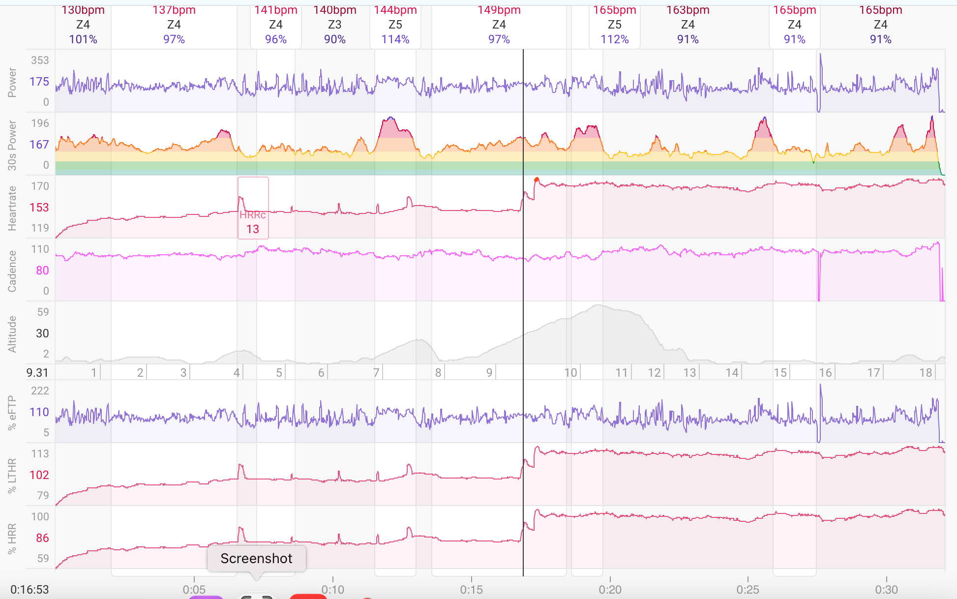

Hello; a couple of my indoor rides recently have exhibited a sudden and sustained jump in my HR that isn’t accompanied by an obvious jump in power or cadence. I have an H10 Polar HRM; could it be faulty? Or could there be a physiological explanation?
Yesterday’s example led Intervals concluding that my LTHR had increased by 6 having been pretty staic for some years. See screenshot of the timeline.

If your power zones are correct, I’d assume the second part of your ride to have the correct HR. Z4 at 140bpm would be pretty good, although not impossible depending on age I guess.
But the line of the first part just looks to have too many flat sections with sudden spikes, whilst the second part looks like I’d expect it to look.

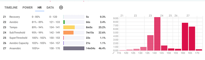

Thanks. The H10 is a chest strap HRM and generally reckoned to be one of the best. The zone chart, based on my regular LTHR looks pretty unlikely (I’m 74 years old).

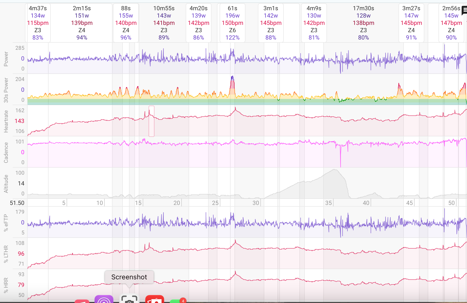

The whole graph looks suspicious to me. Heart rate goes up or down without corresponding to power. How long have you been using this strap?

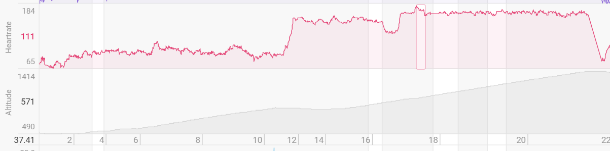

To echo something mentioned already, but getting the sensor areas quite wet has resolved all issues I’ve had with my chest straps. I’ve often seen the same jump from wrist-based HR from my Garmin Instinct, an example of which is included from a full-gas hill-climb I did in 2023. On the first climb (see elevation) my HR was showing as being around 100bpm, when I was actually redlining a bit and had to back off because I was probably getting close to what was at the time, my max of ~185.
