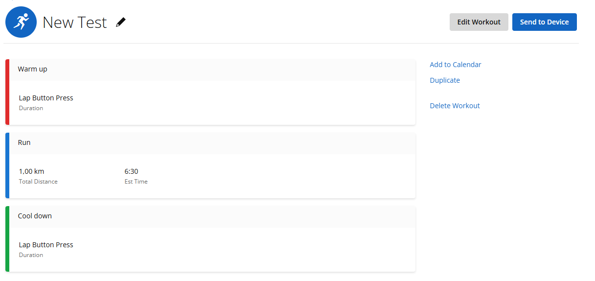

Somehow I was expecting that when a workout on intervals contains various steps, that they would also be properly rendered on Garmin Connect.
See below an example of a workout created directly on Garmin Connect. I would see the various steps.
In the end I don’t care so much though how they are rendered on Garmin Connect but I was hoping that my Forerunner would still execute the steps (like a guided workout) and that does not seem to be the case.
So: is there a way I could create workouts (with various steps) on Intervals, that would eventually allow to be used by the Garmin Forerunner

They will not be rendered on Garmin Connect in the way a Garmin Connect workout is rendered. In Connect, you will see them as formatted text, not-editable in Connect (that’s intentional by Garmin because they don’t want workouts from other sources to be editable in Connect). But that formatted text will result in a correct workout when synced to your device (if the syntax is correct).

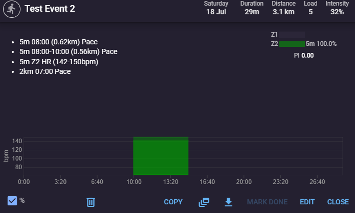

I’m trying to use the API to create these events on Intervals:
  • post /api/v1/athlete/{id}/events
  • post /api/v1/athlete/{id}/events/bulk
The information says:
This endpoint accepts workouts in native Intervals.icu format (‘description’ field) as well as zwo, mrc, erg and fit files (use ‘file_contents’ or ‘file_contents_base64’)
So that means I need to pass:
5m 08:00 (0.62km) Pace
5m 08:00-10:00 (0.56km) Pace
5m Z2 HR (142-150bpm)
2km 07:00 Pace
directly in the description? Feels a bit strange so wanted to check
Not sure on how to pass it through the API, but you should not pass the distance like that. In the workout builder, it clearly shows that passing the distance before the target type, confuses the algo. Either put the distance after the target type or don’t pass it at all.
And you don’t need to pass the absolute HR in between brackets either because Intervals adds that automatically deduced from the Z2 HR.
Try passing this: (works in the builder)
-5m 08:00 Pace (0.62km)
-5m 08:00-10:00 Pace (0.56km)
-5m Z2 HR
-2km 07:00 Pace

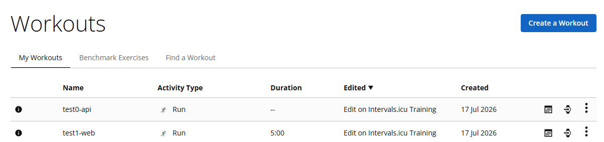

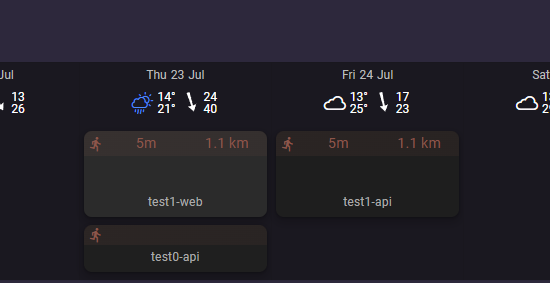

I tried many options this afternoon.

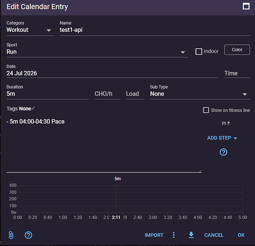

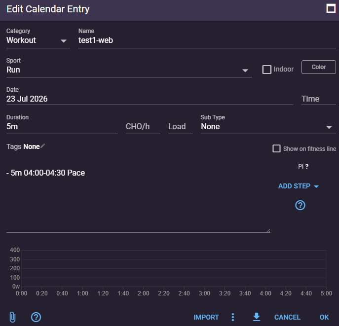

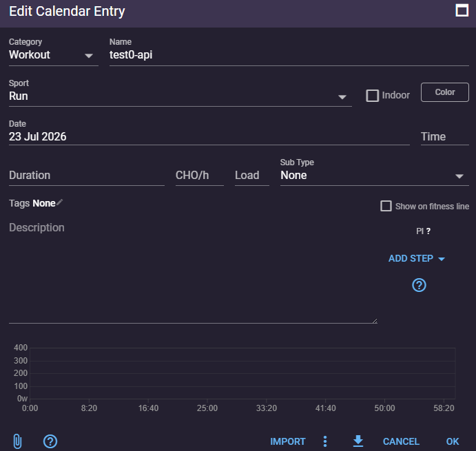

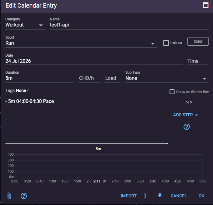

  • When I send an “empty” workout to Intervals via the API, it gets synced to Garmin Connect (screenshot1 test0-api)
  • When I send an event via API with “5m 04:00-04:30 Pace” it does not sync to Garmin Connect (screenshot 2 test1-api)
  • When I send an event via the Intervals UI with “5m 04:00-04:30 Pace” it does not sync to Garmin Connect (screenshot 3 test1-web)
So it syncs always from my custom web app to Intervals, but the sync breaks between Intervals and Garmin Connect when we supply “something” in the description (via the API).
Is there a way I could debug this (e.g. by seeing the logs or API responses)
