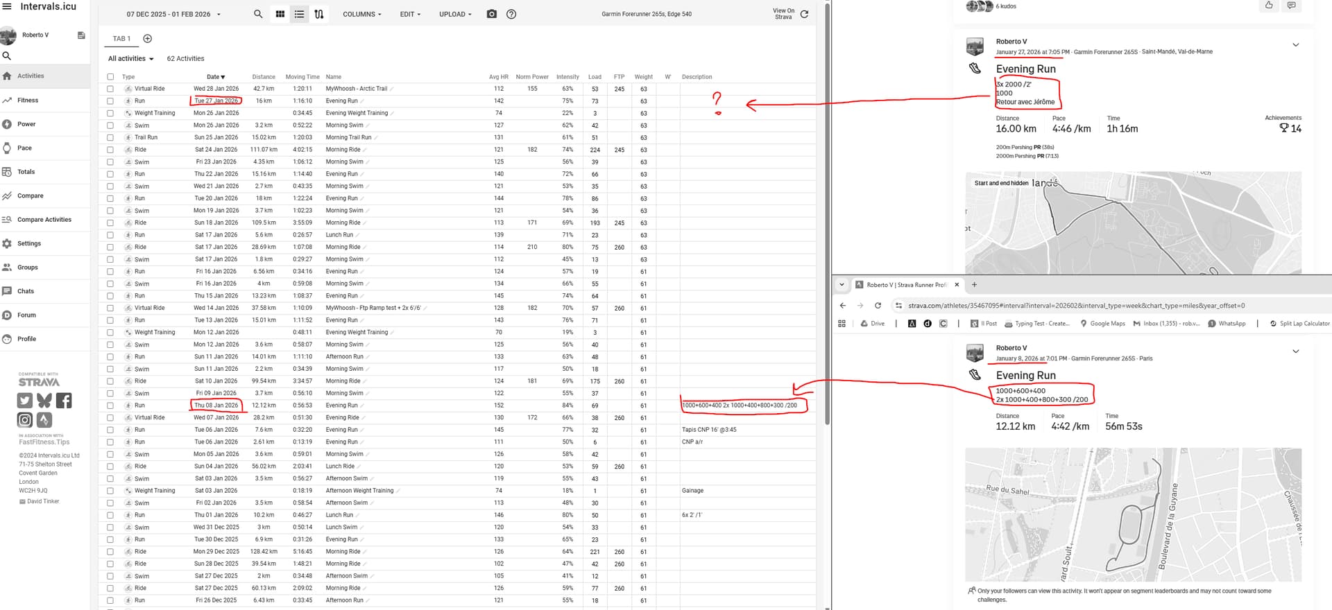

Hello!
I have an issue with importing the descriptions I have in my strava activities. It seems they are imported randomly, sometimes they appear in Intervals.icu and sometimes they do not appear.
I usually write the workout session in the description so it would be very useful to have them all in intervals.icu to filter and search.
see exemple in the image attached
does someone have any advice?
thank you for your help

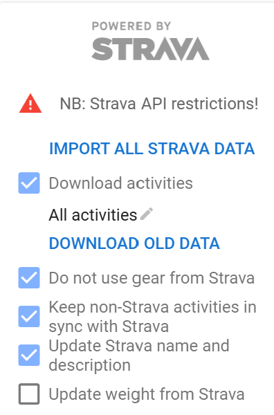

For reference, here is how I have my setup @Doug_Pape
Also, I never record with strava, I record with Garmin when then goes to both strava and intervals.icu. Intervals sees the same workout come in from both Garmin and Strava and then merge/links them into one intervals.icu activity. Maybe one workflow difference / variable is that some of your athletes are using strava app for recording, where as mine are all not “natively” recorded strava, just posted/imported to strava automatically via strava’s garmin connection.
It all gets very complicated very quickly doesn’t it. So many variables. I also have “update Strava name and description” checked and also use Garmin for outdoor activities and mywhoosh or Zwift for indoor. I didn’t even think of what you use to record as I “thought” it all came through Strava. I am learning a lot from this…as always with the interval community.
