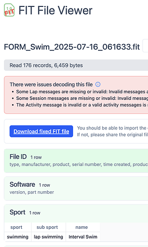

Check one of the FIT files in fitfileviewer.com and have a look at what is in there under ‘sport’ and ‘Sub-sport’.
If the FIT file has the correct sport and/or sub-sport, david will have to check the mapper.

No need to export anything to anywhere. Just open the file using fitFileviewer.com and you can see what is the sport like the screenshot above.
I had a look the the fit file for your morning SUP from 19th of July and it says generic, generic?
