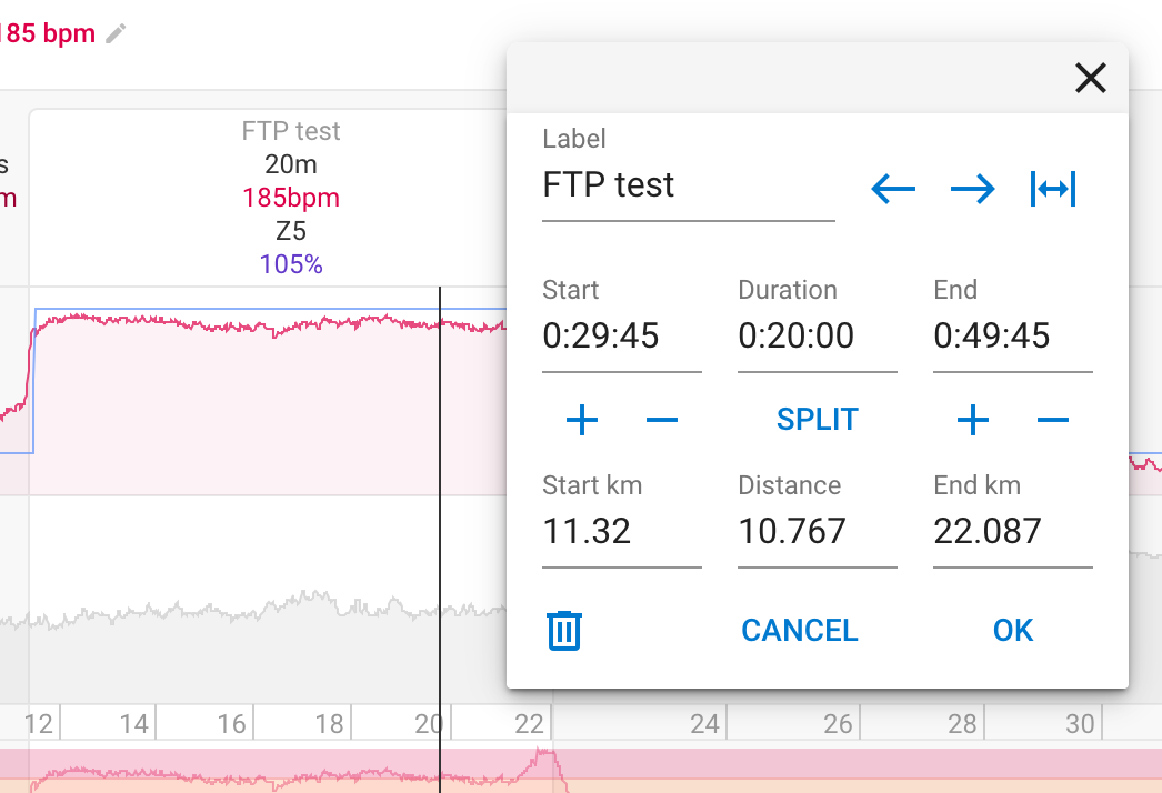

With the cursor (the black vertical line on the very left of the graph in my screenshot) you are able to indicate the beginning of your interval. To create an interval you can press the letter A on your keyboard or you use the button on the bottom of the page. When the interval is created there are at least two ways you can modify it:
  1. You can take one of the edges of the interval and drag it, to make the interval longer or shorter.
  2. You can click on the text on top of the interval (what I called it’s ā€˜header’). This will open a pop-up to fine tune the interval. Here you can rename it too.
As you see, the averages and other relevant information are automatically displayed in the header. In my case: title: FTP test, duration: 20m, average heartrate: 185bpm, zone: Z5, intensity: 105%.
In your case this will also display the average power for the duration of the interval.
You can modify what info is displayed in the header by clicking the button ā€˜Fields’. Then you can select additional metrics like normalized watts or w/kg.
I hope this helps. Best regards.

Paul, your explanation is super clear, but the example data graph you attach is confusing. When I do an FTP test I should be collecting power data, right?
Yes it’s power data you need to collect
Absolutely! However, I don’t use a power meter myself, but the same test protocol can be used to determine Lactate Threshold Hearth Rate, which I use to determine my HR zones and structure my training.
Got it. The confusing part was that you named the 20 minute segment ā€œFTP testā€ when you really meant ā€œLTHR test.ā€ BTW, to determine the LTHR, do you rely on the number intervals.icu spits out, the 181 BPM in your screenshot, or do you have another way of calculating it? In my experience, the threshold numbers the website estimates seem to be a bit on the high side. When I try to stay under my threshold for an extended time, I cook myself, which makes me think the number I’m going on is high.
