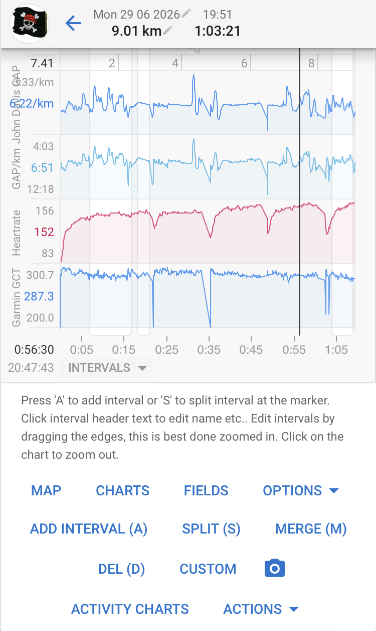

I’ve downloaded your file and uploaded it and it works for me.
I’ve used the Garmin GCT stream from @miguell
Found it (sort of). I created a brand new account and manually uploaded the same FIT file there, and the streams show up correctly. So this is account-specific, not file-specific.Currently digging through account/profile settings and custom fields to find what’s different. Will report back once I find it. Really thanks too much.
The thing I can think of… if there is a custom stream or field which fails (e.g. memory limit exceeded error), the processing of the activity stops and all streams afterwards aren’t calculated. So maybe check if all streams above are correctly processed.
That did it, I removed all custom streams/fields and re-added them using Miguell’s Garmin set, problem’s gone now.
