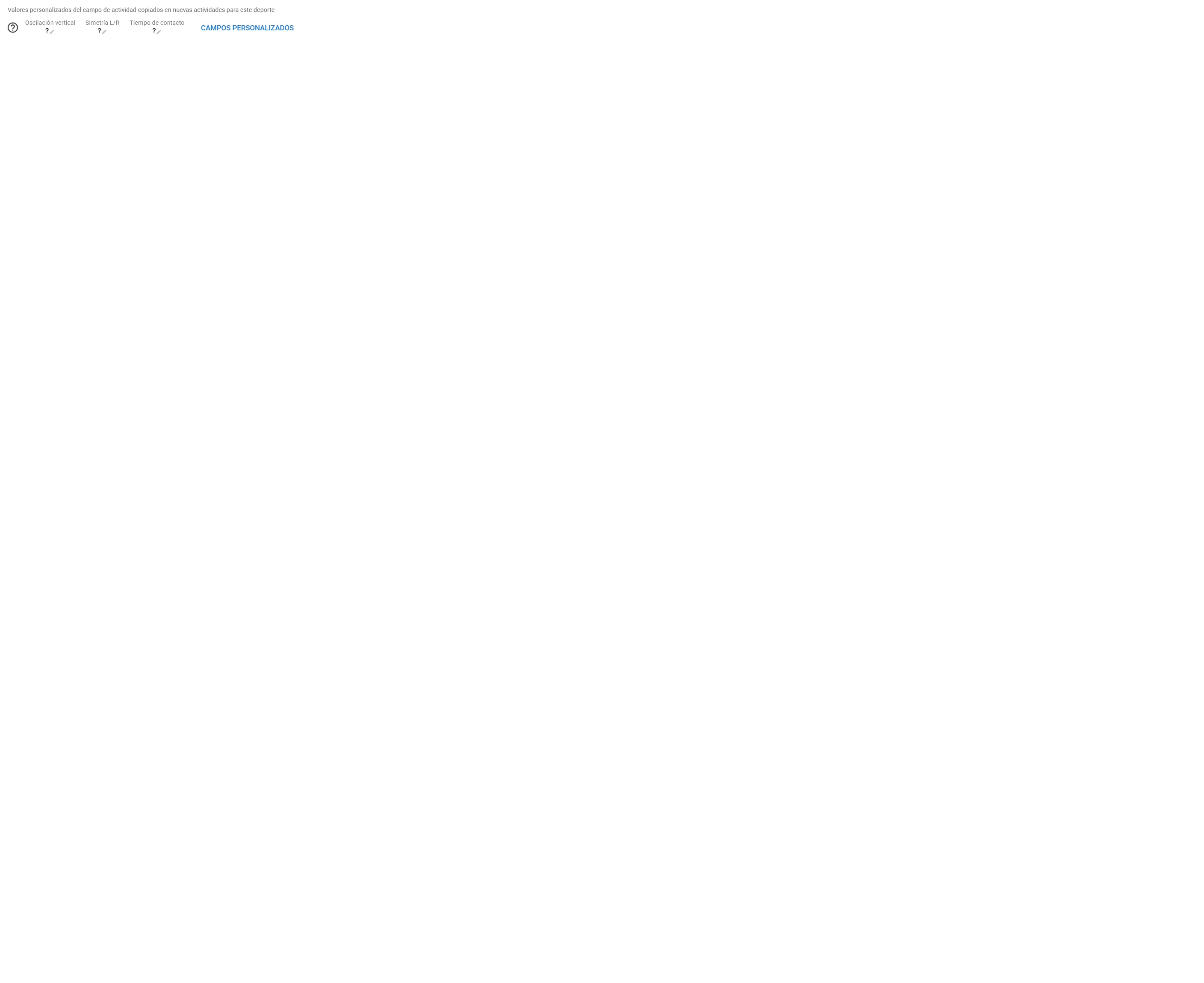

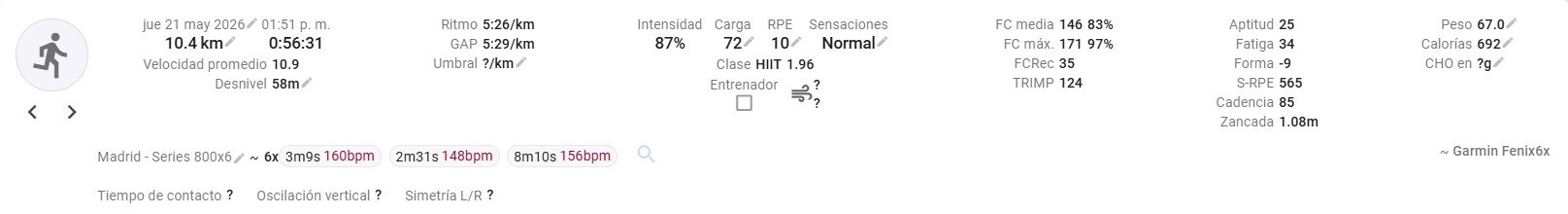

I am trying to map Garmin’s advanced Running Dynamics into my activity summary view using Activity Custom Fields, but the columns remain empty or show a question mark ? even after choosing “Re-analyse” (with all boxes unchecked) from the list view.
I can see these metrics perfectly inside Garmin Connect for my runs (e.g., my recent workout “Madrid - Series 800x6”), but they are not populating the custom fields in Intervals.

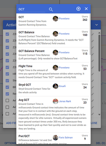

What’s wrong with Miguell’s and Povedano’s Custom Streams, Charts, Fields, Activity Fields…?

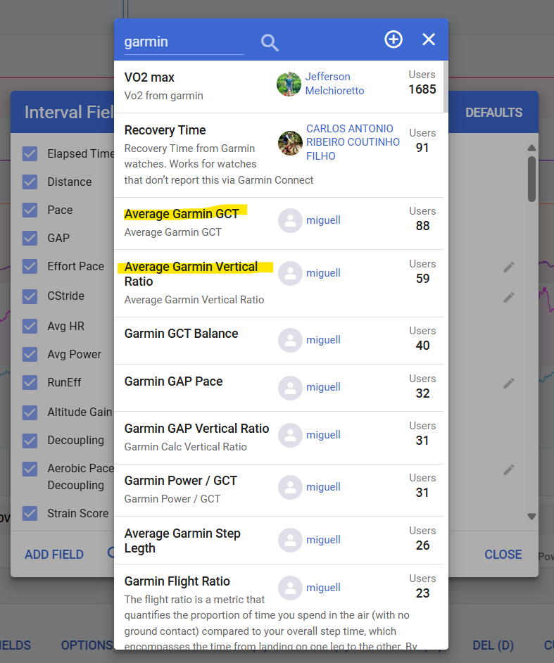

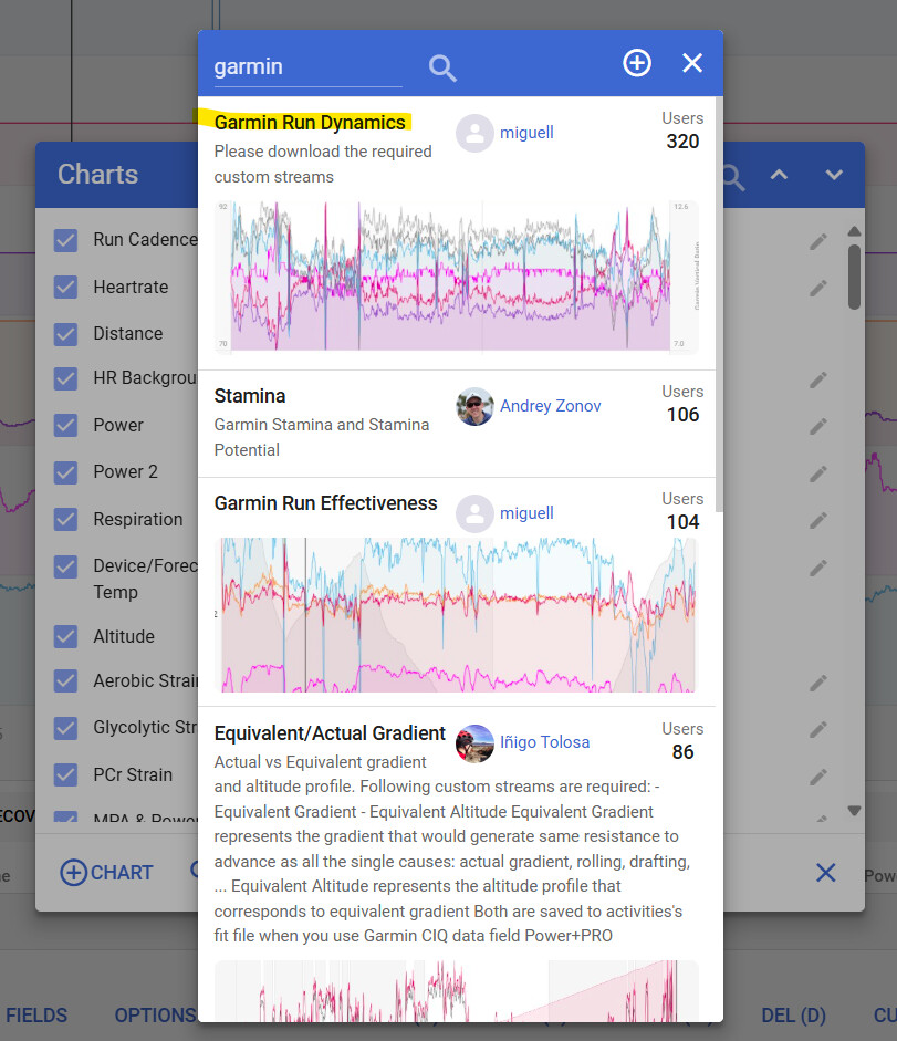

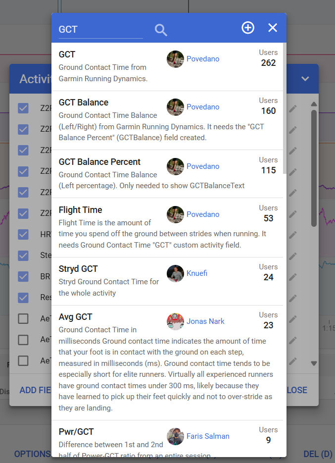

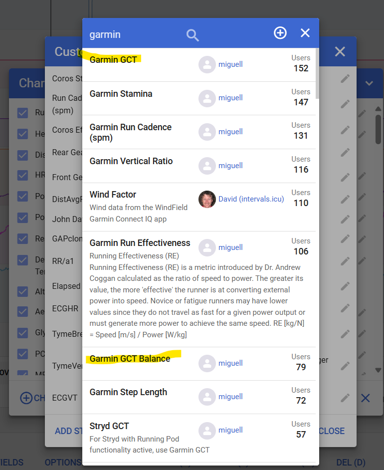

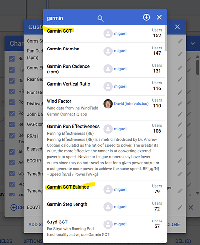

Hi MedTechCD,
Thank you so much for your help and for sharing those screenshots!
It turns out I wasn’t configuring it correctly on my end. I was trying to create the scripts from scratch instead of adding your pre-configured public fields from the community catalog.
Once I deleted my manual fields, searched for yours (Garmin GCT, Garmin Vertical Oscillation, and Garmin GCT Balance), and forced a full re-analysis, the question marks disappeared instantly, and all my real Garmin data populated beautifully!
This is exactly what I needed to feed my AI coaching automation via Make. Thanks again for your amazing contribution to the community!

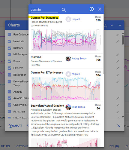

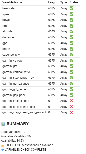

Good you have your Garmin data. I created a Garmin Running Streams Checker script you can run in the Activity Field JS console, that can help AI know about intervals.icu streams.

streamsCheck();💎 GARMIN RUNNING STREAMS CHECK
output:
:gem_stone: STREAMS VARIABLES CHECK
