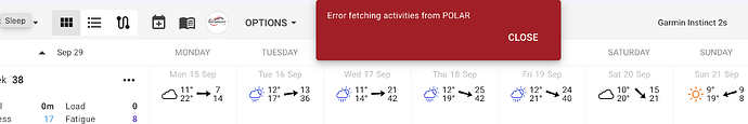

Everything was working well until yesterday, now everytime I open my home I get this error message:
Also tried to reset the connection in settings yet the error is persistent, not sure what is causing it but the Polar API seems unreachable.

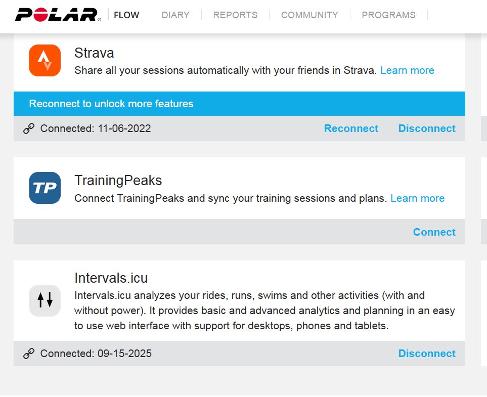

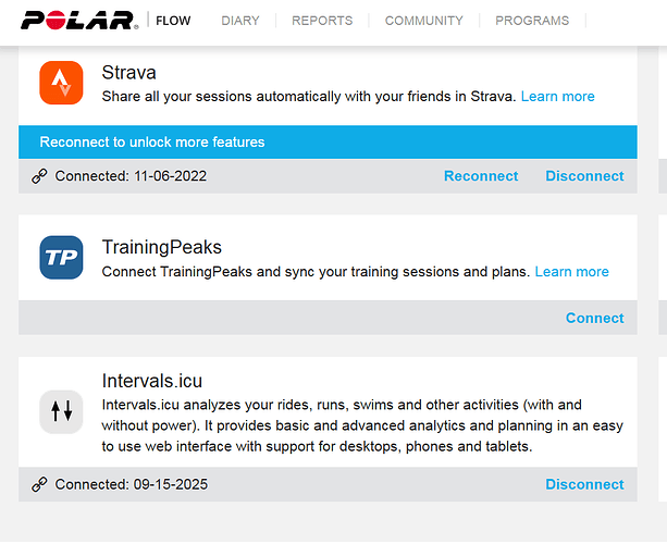

I found where it is in Polar settings . . . Srava has a reconnect option but Intervals does not. I have not looked at that page for so long I dont know if that’s normal
Logged in on a different computer . . . I’m getting the error fetching activities from Polar message but my last two missing activities are now here and when I returned to my other computer it’s good there as well.
Polar shows I’m disconnected and there’s no option to connect

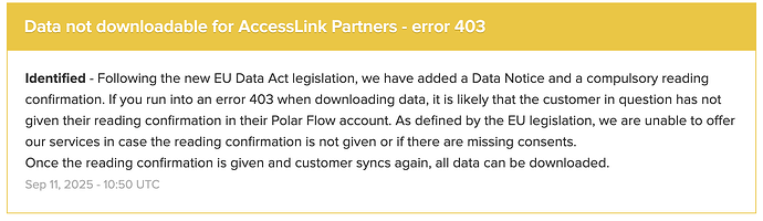

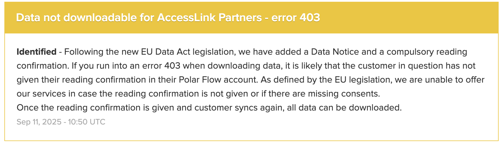

As mentioned by Polar in the status page you should give confirmation to the new data notice, after that a re-sync should suffice.

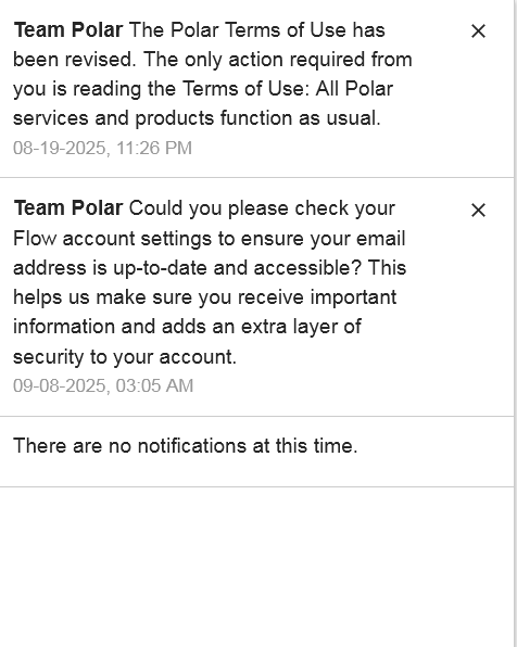

Ive read the terms of use that were recently updated but I cannot find any way give confirmation to it. It was last synced just minutes ago
These are the only notifications I have received . . .
Can only be done from the app AFAIK.

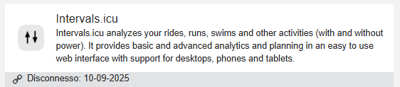

Did you try to disconnect intervals in the Polar Flow account?

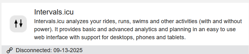

as a matter of fact i did. the problem is there is no connect button now, only the date i disconnected

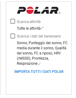

I think you must first click the Checkbox Download Activities (“Scarica attività”) to do a reconnect. I thought I did it that way.
That’s where the json error appears from ( {"status":500,"error":"org.codejargon.fluentjdbc.api.FluentJdbcSqlException: Error running query, update athlete set polar_access_token = ?, polar_access_token_expires_at = ?, polar_scope = ?, polar_user_id = ? where id = ?"})

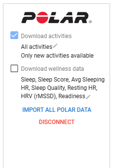

There is a disconnect button below, if you are connected.
But it seems you are in a state, where you can’t disconnect and can’t reconnect. I think only @david can help in this case.

Did you fix this yet? I did not get any notification that this thread was still active. I dont use the app, just the web page. I just had to disconnect in BOTH Polar and Intervals then reconnect from Intervals
This is what the Polar page looks like . . .

From tue Polar UI I can’t reconnect, and from Intervals it doesn’t even know I was connected before.
