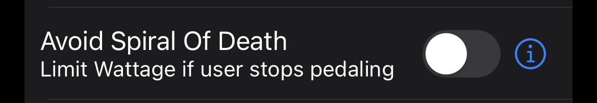

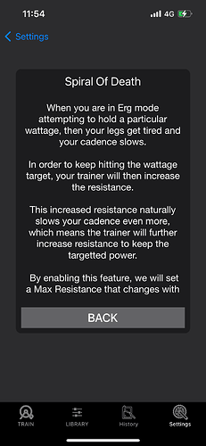

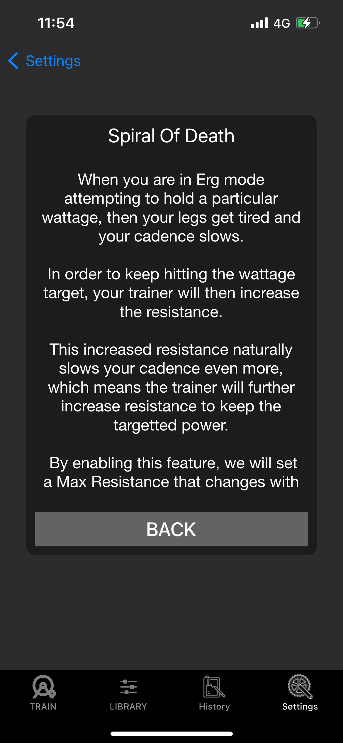

The reason for the Drop is a feature called “Avoid Spiral Of Death” and it detects your Trainer’s Flywheel speed. When it’s < 4ms then this feature will kick in an it will scale the power sent to the trainer by x% of Power Target based on the detected flywheel speed.
Option:
  1. Disable the feature.When you stop for a toilet break at 500w, you will need to start mashing the pedals
  2. Prior to pressing START, start pedaling so the flywheel has some speed.
Hope that helps…
Ok I did have that on. I’ll give it another try.

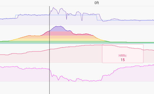

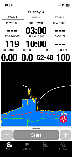

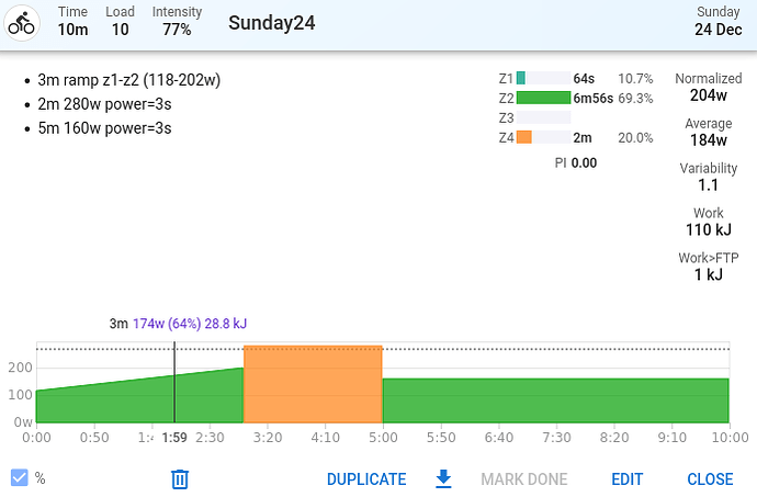

Ok I tried it without the spiral of death and it didn’t drop down the resistance like before, but in a quick test that I made…in the 2 min zone 4 work it spiked the resistance to the max - to where I couldn’t pedal really at all. Jumped from 280w to over 450w. I stuck it out (sort of) till the next section and it dropped back to what it was supposed to do. I’m not sure if this was some issue with my trainer, or some blip in the data stream or what. I’ll give it another go on a real training ride rather than a random test I created.

this is interesting…
can you share the workout you created?
also - what trainer is it?
PowerMatch enabled?
is the BottomMost chart the cadence? This almost looks like the trainer is kicking in it’s spiral of death functionality where cadence is going down and trainer respond by increasing resistance in an effort to get your power & cadence back up.

Yes the bottom is cadence - but the only reason it dropped is because I can’t pedal 75-85 cadence at 450 watts. The power graph dropped off because I was only turning at about 40-45 at that point.
I’m not sure if you want the zwo file - or just see what was built in intervals I’m not sure I can add a physical attachment to send the zwo file so here’s what it looks like:

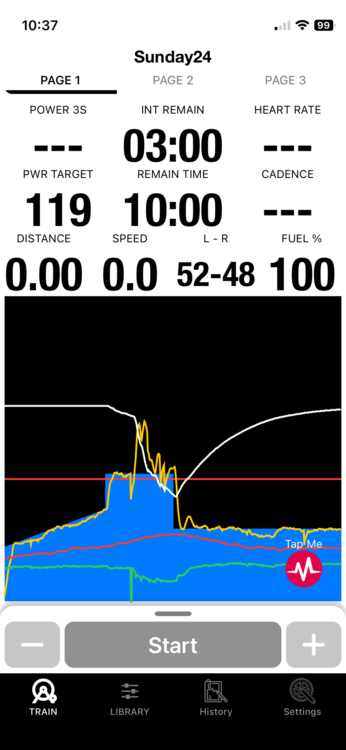

Here’s the view from breakaway app.
I almost wonder if there was a momentary loss of connection to the trainer to read the power…there’s that slight dip in power right before the spike…I wonder if it read a power reading of 0 watts for a second during a connection drop…and therefor it ramped up the resistance…but didn’t come back down because I couldn’t actually pedal very well for it to realize it was too much resistance.

i am also noticing this where the cadence dropped down to zero. Usually this would be where Avoid Spiral Of Death kicks in and progressively ramps you back up to the power target.
Screenshot 2023-12-24 at 11.48.16 PM
Without the Avoid Spiral Of Death feature, the trainer’s built in algo kicks in and ramps up the resistance. The longer you take to get up to the power target, the more resistance the trainer sets. It’s a vicious cycle.

One question on the spiral of death - above you said it detects flywheel speed - since I’m not on a traditional trainer, I don’t have a flywheel speed being sent to the app - ever. Is the spiral of death really on flywheel speed or pedal cadence - I wonder if this is causing the dip and the spike, for certain you’ll need logs but I wonder if it’s expecting some value (with it off or on) for flywheel speed and my trainer is not sending it at all.
Will have to see if the Flywheel speed is sent then based on the logs… FTMS trainers will send that number.
I do have code that will put a default number so that it will ignore it

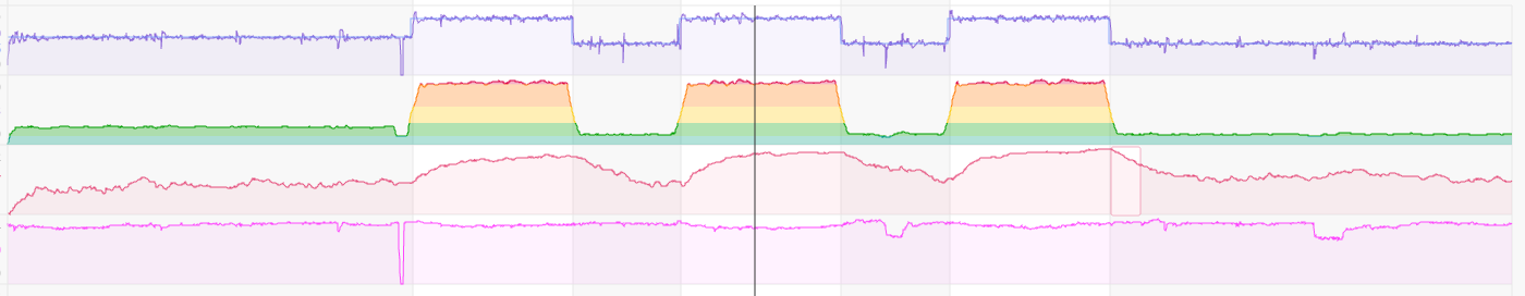

I was able to do a ride today ahead of plan, a full ride…no issues at all, no random power spikes or runaway resistance. I had a dropout of the connection to the trainer/power but that didn’t cause any issues. The graph just dropped to 0 for a second or two.
I have log file you can get to here if you want to look at it even though nothing went wrong - although perhaps knowing that I have a homegrown ‘trainer’ that spiral of death isn’t working for me…as soon as you turn that on even if I have a cadence of 85+ and watts of 150 - 300 it drops the resistance right down to 20 as soon as that’s enabled - seems like whatever algorithm that is using, doesn’t apply for my device.
Ride Graph (bars are from top to bottom : Power, 30s Power, HR, Cadence)

You are right… Based on the logs SS2K is indeed sending the flywheel speed (as it should based on the FTMS protocol). But may not be reflective of the actual flywheel speed. (Vary between 1.1m/s to 1.4m/s which is way below the 4m/s for Avoid Spiral Of Death to kick in)
Also, since your trainer is sending flywheel speed (instead of not sending at all), my algorithm won’t default to ignoring the speed number.
Next time, if you do happen to get the situation where the power gets out of hand, try using the +/- button to RE-SEND a new power target to the Trainer. When power match is turned off, the Trainer takes over maintaining the power target once sent at interval start.
