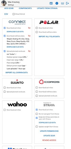

Configured like the image, went for a ride with a Fenix 3 watch and after saving the activity it didn’t sync to Intervals (it’s there now but I uploaded manually).
I don’t see any errors in the logs or anything for you for Garmin. If you next ride doesn’t download automatically please post on this thread. Also make sure you have connected the correct Garmin account.

hi @david , I’m having the same issue and found this thread. My settings on both sides are fine and the activity has been recorded with a garmin forerunner 965. any chance you can look into this? I’d really appreciate it! Best, Max

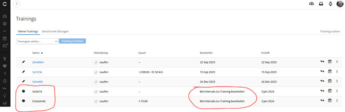

I am not seeing any activities come through for you from Garmin (no webhooks). Planned workouts are uploading fine. Can you see the planned workouts on your Garmin?

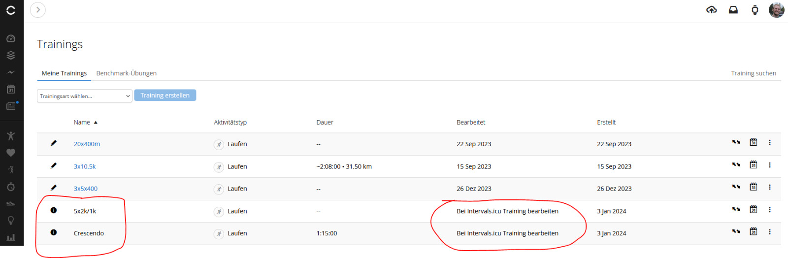

yes, syncing trainings to garmin works perfectly

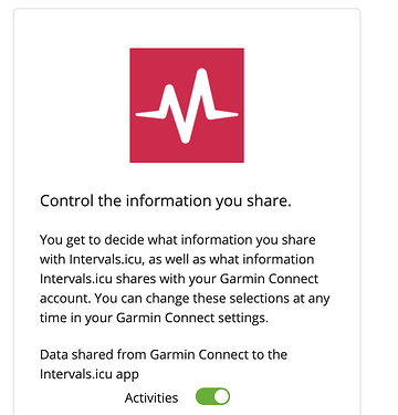

Did you check the activities box when you connected? Try disconnecting and re-connecting to make sure.
I can’t think of anything else to try :frowning:
disconnecting and re-connecting fixed it this time (not the other times though, not really sure whether I did anything different there, though…) :champagne: thanks!:heart:

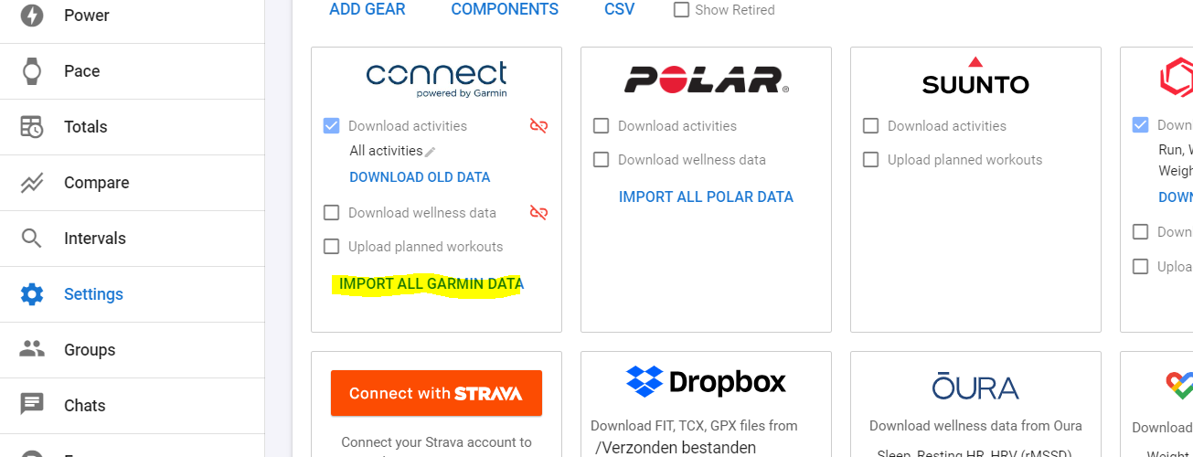

How long should it take until the old activities are showing up? Right now I see last 90 days only. Is there a limit for how historic the sync will be or will it eventually sync all existing activities from Connect?
Use ‘Import all Garmin data’ on the settings page to get your full history.
Garmin will send you a link within a couple of days, where your complete history can be found. Paste that link in the dialog box on Intervals and everything will be imported.
