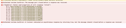

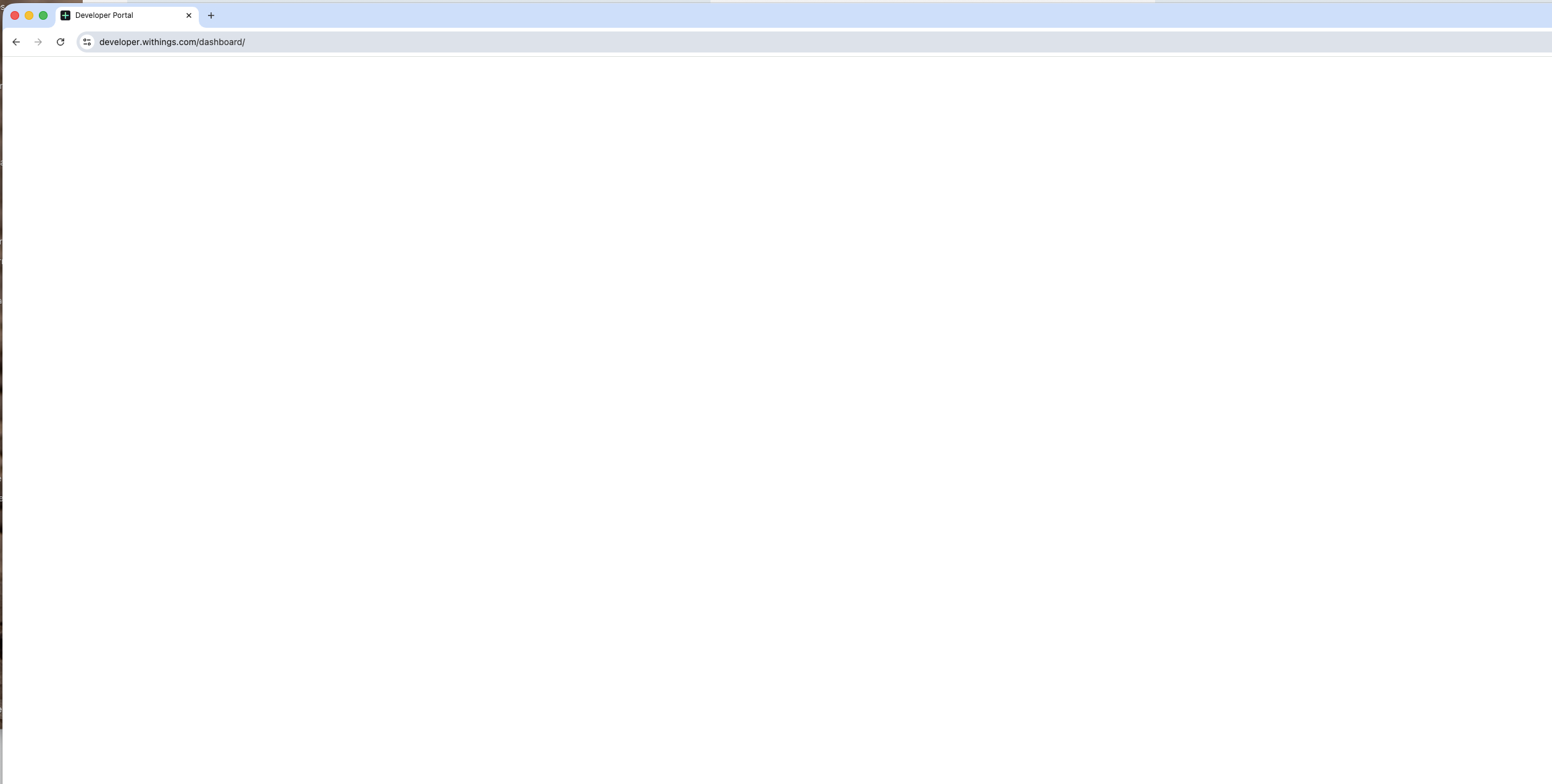

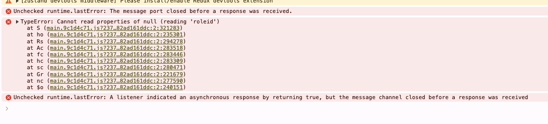

I’m trying to set it up but I’m stuck at the developer portal of withings. the page is completely white. is it just me? (tried to use different browsers, incognito mode, usual stuff…)

I go to the page, then “log in to Withings Partner Hub”, select “public Cloud”, insert my credentials and I am redirected to Developer Portal but the whole page is white. no content, nothing.
I tried with Brave, Safari, Chrome.
deleted cookies and tried also on incognito mode
I’m logging in with my withings account or with a newly created one :thinking:
that’s weird… I’ll contact Withings support!
