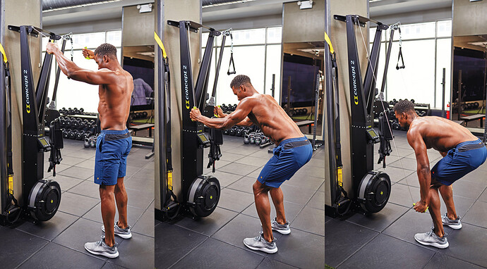

Will it be possible to add “SkiErg” or similar as an activity type?
Concept2 SkiErg is an indoor training equipment used to train/simulate polling in XC skiing. The equipment will give out data such as cadence, pace/distance, and watt. By default this is logged as Nordic Skiing on Strava.
It is true that it is related to Nordic Skiing / XC Skiing, but so is Roller Skiing as well – which is a separate activity type. My main reason for asking is that any pace records and watt records will be very different on the trainer vs skiing.
