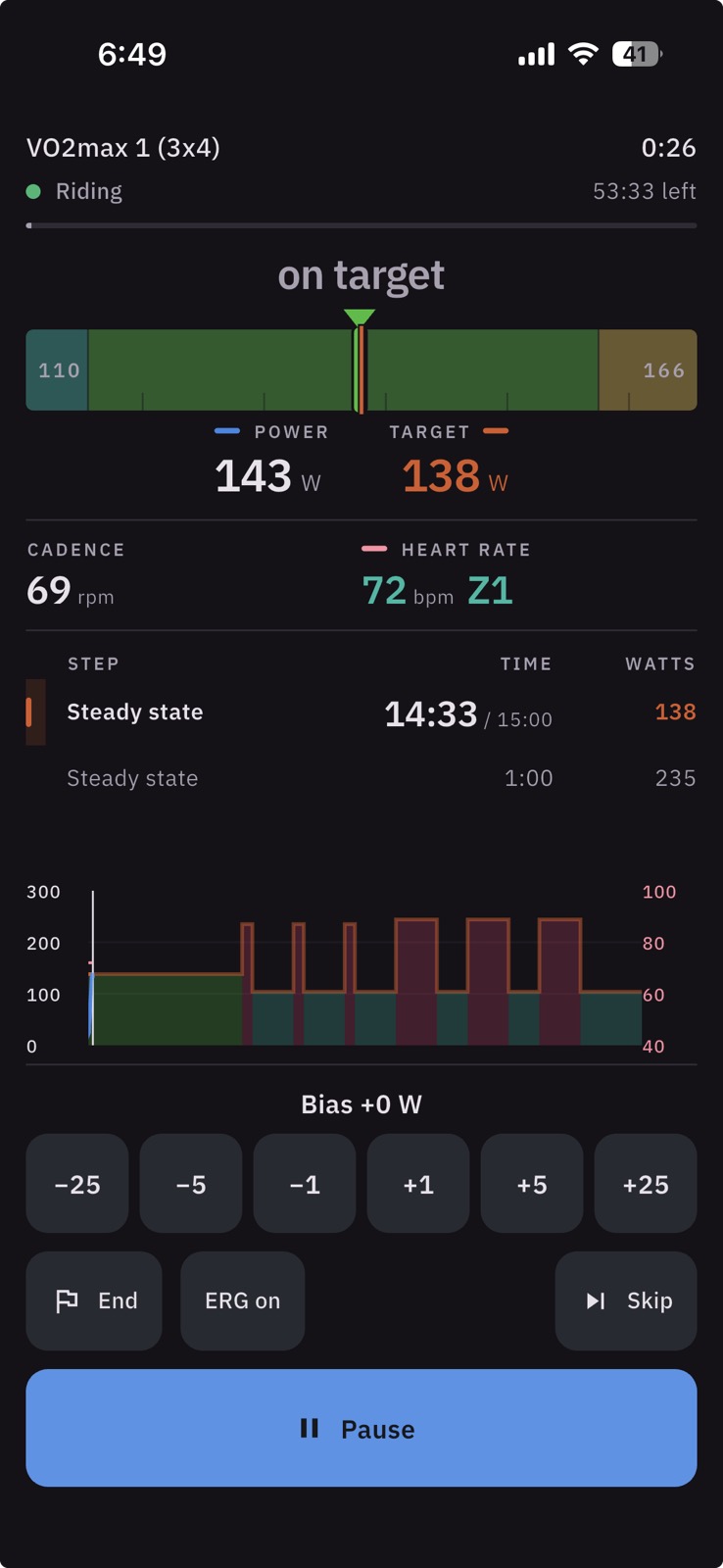

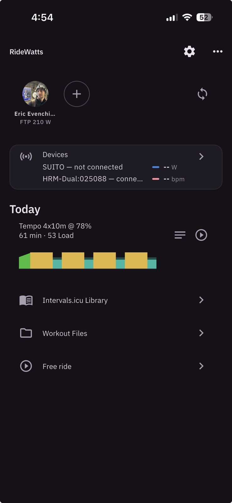

I’m working on RideWatts: an app for doing your Intervals.icu workouts on a smart trainer. My goal is to have the fastest time between opening the app and doing your workout for the day. It’s free and currently supports iOS, macOS, and Android. I have a beta that could use some testing on more trainers and input from the community.

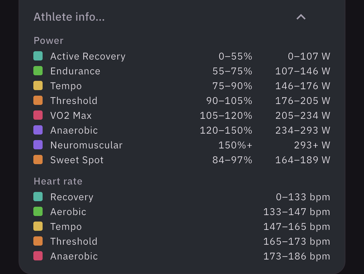

Intervals.icu integration includes OAuth login, showing your daily workouts, your full workout library, and pulling FTP, power zones, and heart rate zones. Completed workouts can optionally be uploaded to Intervals.icu. You can link multiple accounts to one device and quickly switch between them.
Both ERG and resistance modes are supported and I’ve tested with the Tacx Neo 2 and Elite Suito. I’m looking for folks to test on other trainers and provide feedback. It should support any trainer using Bluetooth FTMS, as well as Tacx trainers that speak FE-C over BLE. If you don’t know what that means, it most likely supports yours!

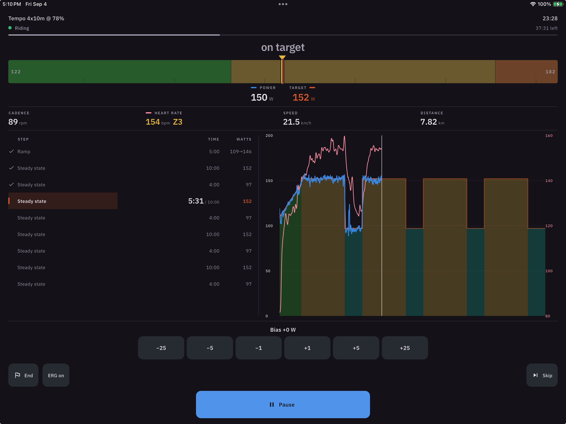

Yep, everything gets planned in Intervals.icu which has a nice text based way of doing it, you can also import workout files into Intervals.icu.
When you want to do your workout for thee day you just select it and the app will command the trainer’s ERG mode to force you to hold the correct power for each interval. When you’re done, HR and power data go back to Intervals.icu.

Also, I am unsure if Auuki reads your FTP, power zones, and HR zones from Intervals.icu. Having used multiple apps and devices, it was always annoying to make sure these are set up the same in each app. RideWatts loads all of this from Intervals.icu so you only need to set it once.
Another thing I’ve seen other free apps lacking is multi-user support. This is helpful when you have multiple people using the same trainer setup.

Not sure why I’d need power zones in my playback app? The workout export from intervals Auuki contains everything I need: for each interval it has power, duration and rpm targets.

I like seeing the HR zones to know which one I’m in. Power zones are maybe less useful to if you’re just doing structured workouts, though I like them for non-ERG stuff.
Glad Auuki works for you, we have an iPad for the trainer so it looks like it’s not an option. This app is mostly a thing I built to address my gripes with various apps I’ve used… it started when ROUVY had a bug disconnecting my trainer which they could/would not diagnose :smile:

I decided to give it a go today and it worked really well very impressed.
I have a JetBlack volt trainer and it also broadcasts my heart rate. In your app I had to pair both separately. It would be great if this could collect all data via the volt trainer.
also I noticed the workout paired nicely and wrote back to intervals.icu and was very easy to setup
The final activity it would be good if the activity could have laps recorded. I did over unders with a ramp warmup and cooldown.
