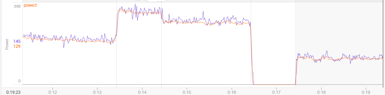

BTW, from the indievelo days they recommended a website called dualrecording.com which is great for comparing the output from two different power sources. That is what I have used in the past for my indievelo/TP Virtual rides since it is interesting to see how closely the two power sources correlate.
I like this one
You can choose to compare 2 power streams from one single FIT file or from multiple FIT files. Align them and analyse.
But given the recent addition in Intervals and the plans that David has to make in-depth analysis of the second stream possible, it will not have much use anymore for FIT files with multiple power streams.

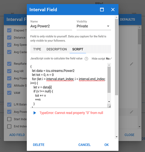

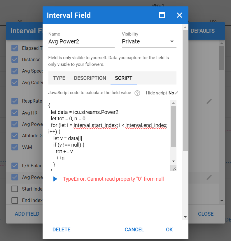

I can’t find the field Avg Power2 (and other related) and also can’t get the Custom field to work since it now is a native stream. Or I’m doing it wrong…I’d like to get an idea of the avg difference.

Following script works fine:
let temp = streams.get(“secondary_power”).data
let tot = 0
let c = 0
for (let i = interval.start_index; i < interval.end_index; i++) {
let v = temp[i]
if (v) {
tot += v
++c
c ? tot/c : null
Thanks, I missed that. Working fine now.
Got confused because in the charts it is called Power2.
The charts include the name of the record field from the fit file for extra info but internally it is always secondary_power.

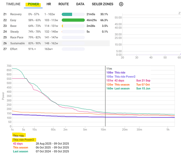

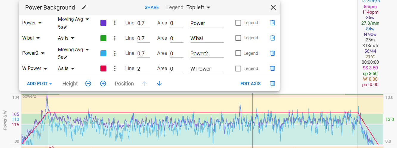

I may have missed this - I’ve managed to set up dual recording and display on the main graph, which is great. The question that came to mind today when uploading a file to dualrecording.com to check things over was…since intervals already has the data, can I put it on a tab on every activity by default? Reading around I think the answer is no, but if it is possible it’d be a great thing to add!

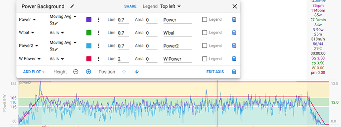

Not sure if this answers your question but if 2 power streams are available, Intervals can display both on a Timeline chart. This one also has Workout Power.
And you can compare both on the Activity Power tab
Perfect! I was wondering how to add the secondary on the power tab (i managed to set up the timeline to show both a while back) but on looking closer I see clicking Options > Streams gives a checkbox for power2 - brilliant!
Intervals is way ahead of most other options having all these things to play with :smiley:
Me again! Is there any way to get this sort of data on the power tab? Trying to duplicate dualrecording.com displays :face_with_monocle:

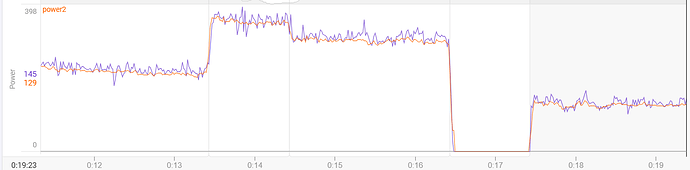

Hi, today i did a ride on biketerra it recorded my power via my home trainer + my pedals favero assioma
On icu i have two curves one called power and the other called power2, how do i know which one is associated with which powermeter ?
Power is the default one from your power meter.
BikeTerra records both if a power meter is paired. The power sent to the trainer is stored as power2.
Hometrainer (Saris H3 is less precise it seems), its good that I record with my pedals
There is a lot of noise thought
That is a normal trace for a real power meter. If the trace is smooth, it’s NOT from a real power meter.
Use 3 or 10 sec smoothing.
