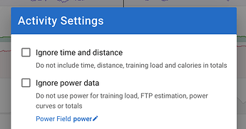

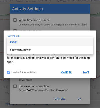

If you are using 2 power meters (or Garmin and Stryd for runners) or training indoors with software that supports trainer power and power meter power, it is now easy to compare those on Intervals.icu. Do Actions → Settings and click “Power Field” to choose the primary one used for activity analysis etc.:
The power field you have selected is called “Power” and the other “Power2”.

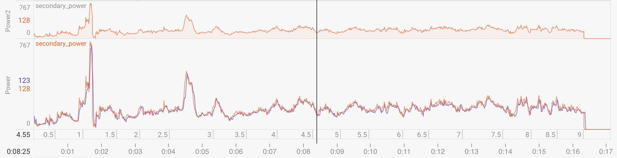

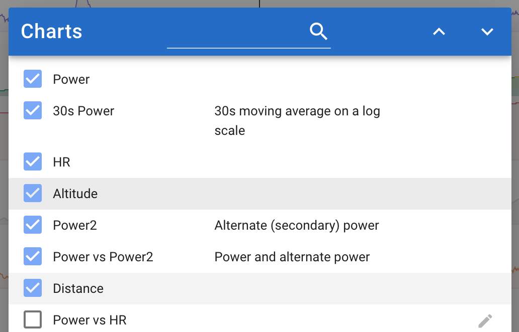

Click “Charts” under the activity timeline chart and search for “Power2”:
You can also create your own custom charts and add “Power2” as a plot (e.g. to add smoothing etc.).

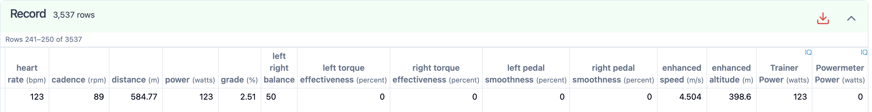

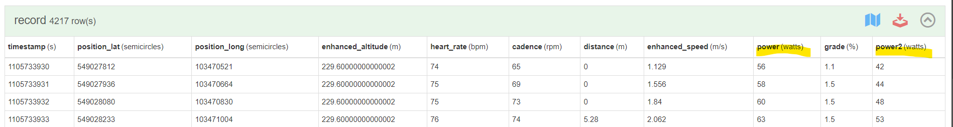

Just tried this with a TP Virtual fit file with dual data but it did not work. Not sure what they call the secondary power in TPV (Powermeter Power ?).
I had a look at your most recent TPV file on fitfileviewer.com and the “Powermeter Power” field is all zero:
“Trainer power” matches the standard “power” field.
If you can point me at one where “Powermeter Power” is filled in I can add support for that field name. I have older indieVelo files and they work.
Yes the file from the 19 Dec 24 definitely has dual recording. Thanks

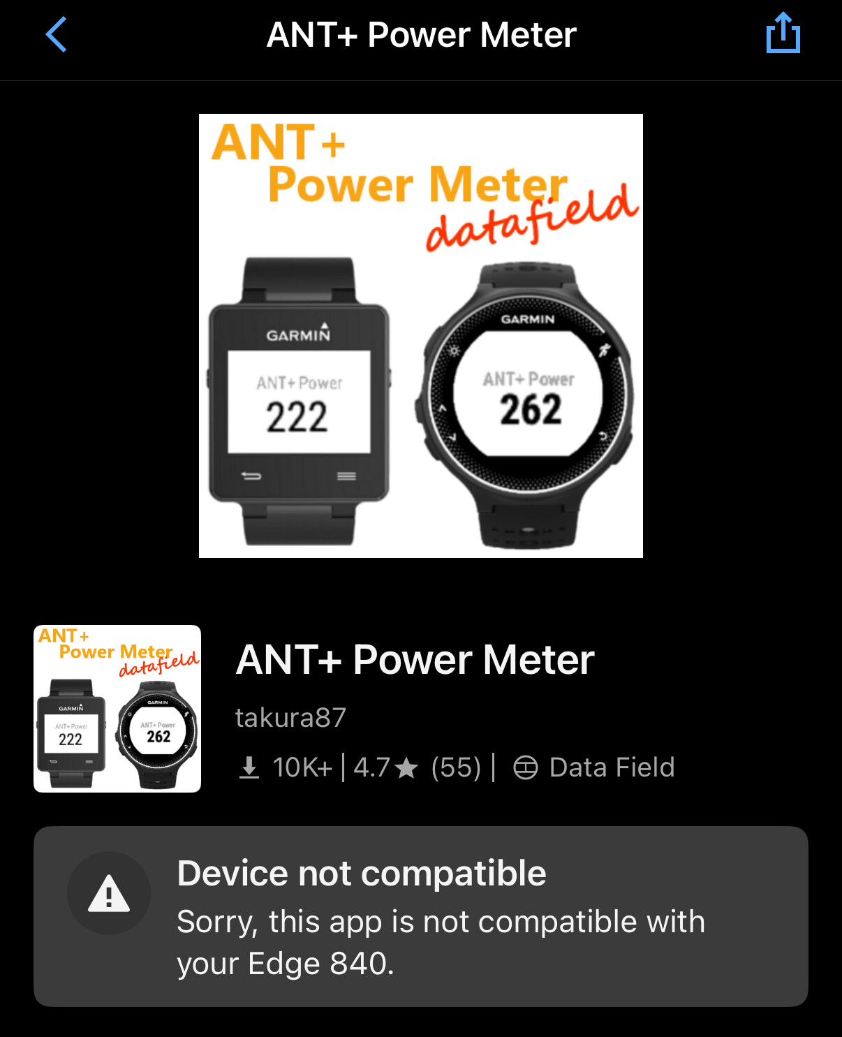

Hmm, this is what I get:
Maybe I missed it above. I rarely look at CIQ store. Did a quick search and nothing. Im sure it’s impatience on my part. Do you have a name of a CIQ app or data field to allow 540/840/1040 to record a second power meter?
