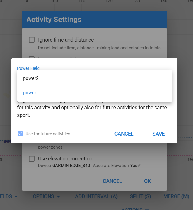

Secondary power trace added
Tx. You should see it now if you reprocess activities with dual recording.

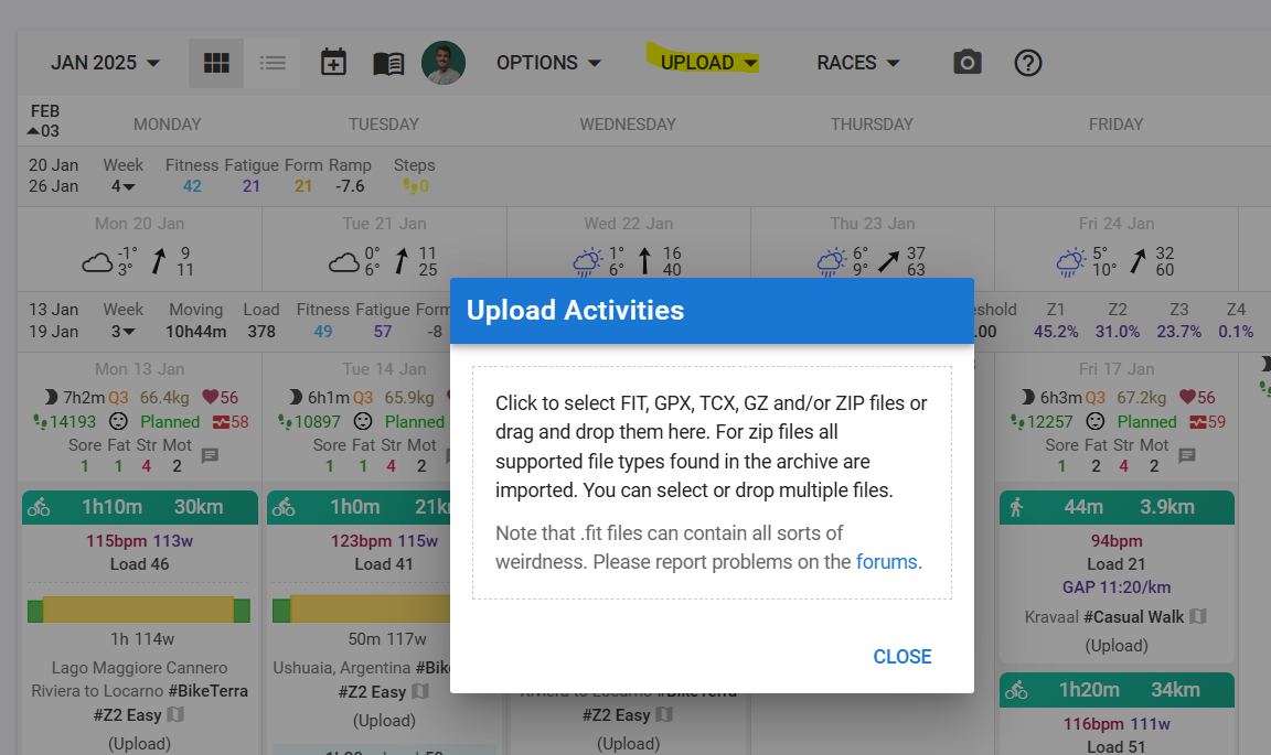

I’m going to take a (maybe not so) wild guess at this…

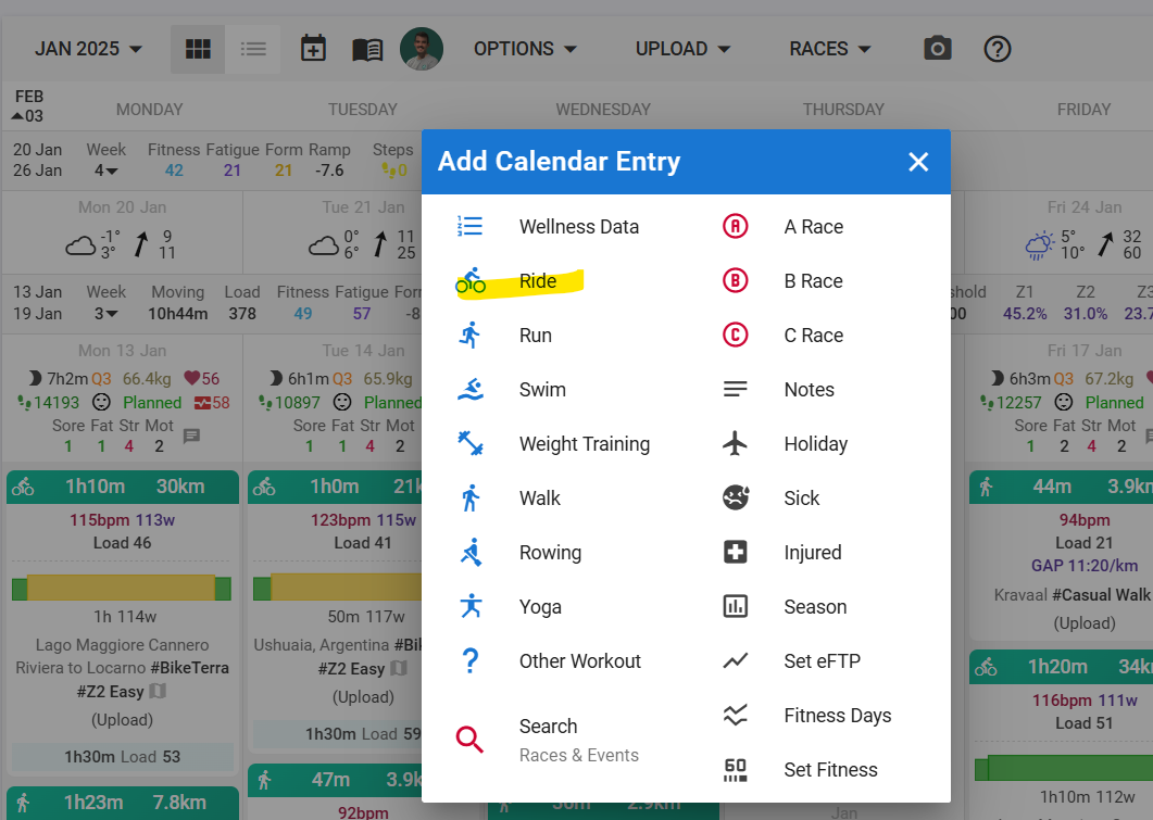

Did you try to upload an activity file through this?:
If so, that isn’t going to work because that is for planned workouts.
Finished activities have to be uploaded from here:
When reporting problems, bugs, requests… try to always include ample information and preferably screenshots. Things that look ‘obvious’ for new users are not always understood ‘obvious’ for experienced users who know their way around the vastly expanded possibilities.
No. I tried to use the upload feature in the forum reply so David could see the actual fit file from TP Virtual. I know how to upload an activity file to intervals.
Ah, you tried to upload here on the forum for investigation. The forum does not allow those files…

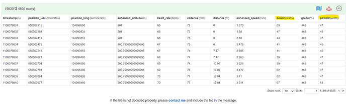

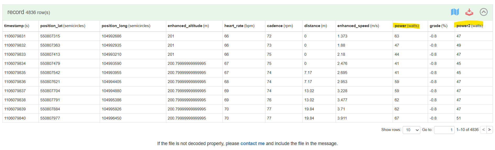

You could try to open your file with FitFileViewer.com to check if it has a second power stream and if so, how it is called. like this example:

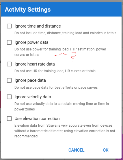

If it has something already known by Intervals, reprocess the file and then check in Actions Settings under Ignore Power if it is listed a second stream.
Hi, Can’t find this editable field?
It only shows up on activities with power. I just looked at your most recent ride (ramp test) and I could see it.

Found it after few tries?! But can’t get the secondary power . I had it configured on MyWhoosh. Anyone who knows if it is exported?
BR Steve
I had a look at your file on fitfileviewer.com and there is no secondary power. That file was recorded on your Garmin. You probably need to download a file from MyWhoosh. Unfortunately I haven’t been able to progress direct integration with MyWhoosh. You should bug them about that :slight_smile:
