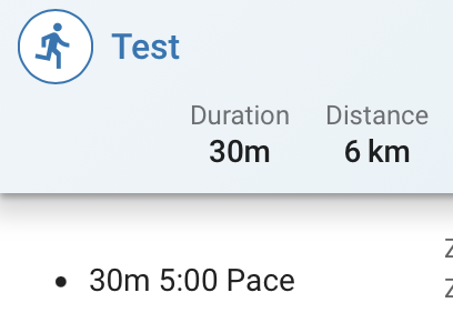

It estimated/calculates the distance already
Thanks for checking. It works when the workout explicitly specifies an interval with Pace, but not automatically. For example, ‘- 30m Z2’ doesn’t estimate distance. It only does when you add ‘Pace’ to the end of the line.
It just seems a little inconsistent. Load and duration are always calculated, regardless of the way you specify your workout, but distance isn’t.

Nothing specified is always Power. For Pace or HR, you need to specify.
Of course I can estimate my pace, my zones are all aligned. The HR zone lags compared to the power and pace, and the pace zones aren’t accurate over elevation, so I get that power is the default for some things, but generally speaking it should all work out the same.
And as I mentioned above, it does work that way when it’s the other way around (when I specify a distance and a power zone, it uses my pace zones for a predicted duration).

I use power for the alerts, but you can add pace for the distance estimation like in this example:
  • -2km z1-z3 power z1-z2 pace
    6x
    -6m SS power z4 pace
    -75s z1-z3 power z1 pace
    -10m z1-z3 power z1-z2 pace
Works like a charm.
