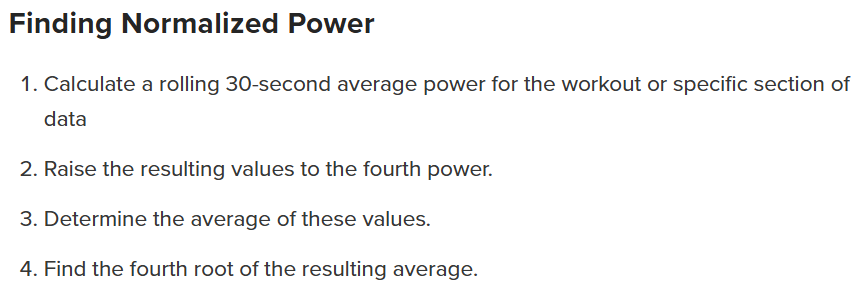

The reason is that the load from Pace isn’t processed in the same way as with the Power. For Load from Power, the algorithm uses NP (Normalized Power) which drastically increases load for higher efforts because it is a result of the 4th power value.
This webpage explains why it is important.
This doesn’t work for pace, AFAIK, and consequently isn’t used. Like said in the former post, use Power if you have it. Else HR may be better for interval runs. Pace should be pretty good for steady runs.

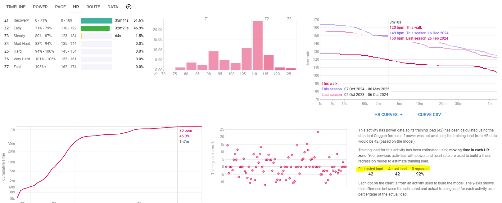

Which one of these are you using for HR load?
And what’s the result of the in-build model for HR/Power load?

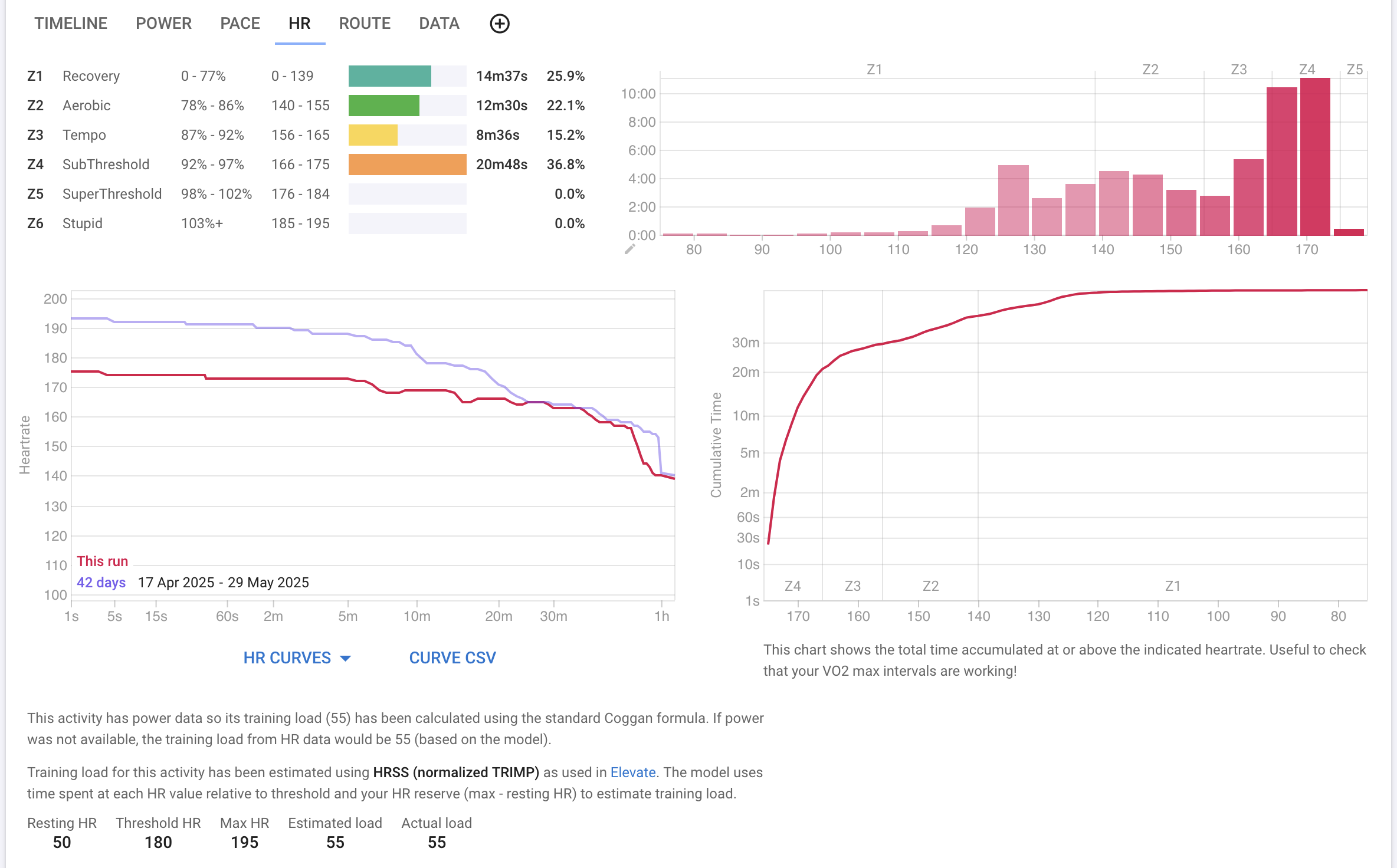

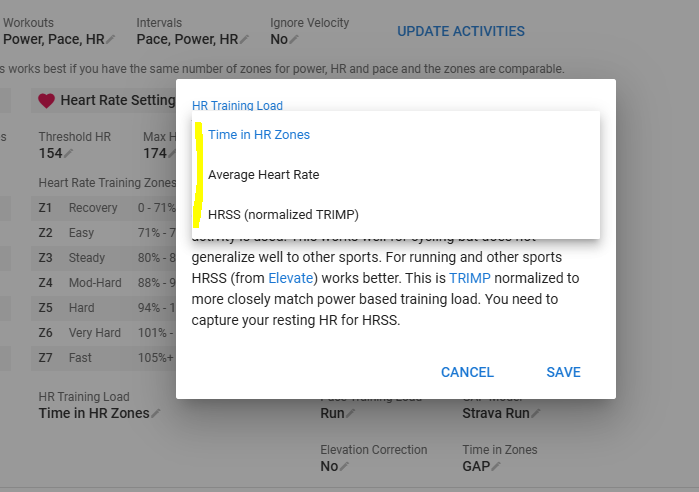

Thanks! I’ve set it to “HRSS”.
Not sure exactly how to display the HR/Power load. This is what my HR section looks like from today’s 5 x 1600m:
For comparison, power load for this session was 76. My 75 minute easy long on Sunday got a power load of 71, whereas the HR load was 38. So where it’s almost a 1:1 ratio for workout:easy long going by power, the HR ratio is 1.45:1.

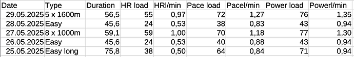

Here’s a spreadsheet showing the numbers to more clearly communicate my question:
What’s likely to be the “most correct” ratio between easy running and workouts load/minute? HR or Pace/Power load ratio?
Thanks! I’m sure it’s a can of worms, indeed. But is there a “general consensus” that one ratio is more correct than another?
I’ve chosen HR load simply because the ratio is more in line with my perceived effort differential. A 75 min easy run feels like a breeze compared to a 30 minute threshold workout + WU and CD. But if the goal is to have CTL track fitness as closely as possible, it seems one has to be more correct than the other.

First you calculate NP for the entire activity (Normalized Power is a way of making harder efforts count more - look it up).
Then you calculate IF - Intensity factor which is NP/FTP in %
Then you multiply IF squared by duration in hours and you get the load.
If NP comes out as equal to FTP, IF is 100% and and if you do that 1 hour you get a load of 100.
If NP comes out as 0.9 of FTP, IF is 90% and 1 hour results in a load of 81.
The more rest minutes and the lower the rest intensity, the lower NP becomes and thus the load.
