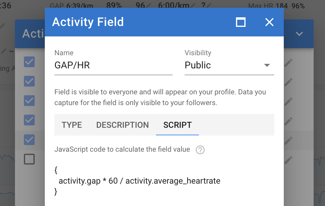

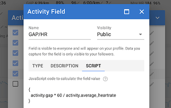

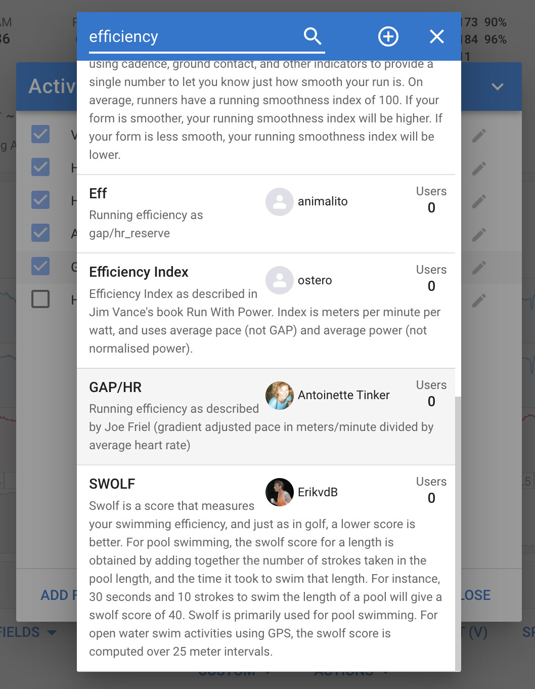

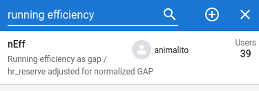

I have just created a custom activity field for this (GAP/HR). Other people have created several different running efficiency metrics some based on heart rate reserve. You can find all of these by clicking “Custom” under the activity timeline chart and doing search:
The calculation for this one is simple:

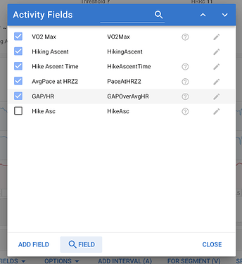

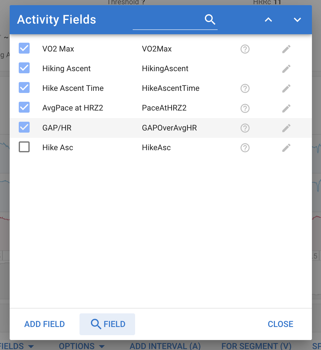

You need to add it to each athlete. Older activities need to be re-analysed to pickup the new field. Easy to do this from the activity list view:
Choose “Edit” and “Re-analyse”. Tick the “Keep existing intervals” box.

Been playing around with this too. But I don’t understand why anyone would want to use HRreserve. If your resting HR is elevated, which usually isn’t a good thing, the efficiency factor would be higher…
Can someone who uses it like that explain me what the purpose is?
Are you referring to this shared field?
I think the idea is that (average HR - resting HR) better reflects the level of effort exerted on that day than simply average HR.
As for a resulting higher efficiency factor: Imagine that you match someone’s GAP and average HR but they have a lower resting HR – they required a higher increase in heart rate to achieve the same speed as you. You could say you’re more efficient. :slight_smile:
With that said, I’d rather just follow Training Peak’s formula as it’s easier to understand and should result in less variance.
Is there one of these custom metrics using exactly the TP formula?
No, because the NGP formula TP uses is not public. See this for a more in-depth discussion:
With regards to EF, I believe David’s GAP/HR is the closest you’ll find here.

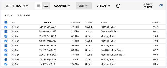

I’ve been using the GAP/HR metric on the Compare Activities page and I can make it show as a column in the list of activities being compared.
But I can’t see any way to make a chart of GAP/HR over time (i.e. date) to visually track improvement in GAP/HR for the activities being compared. Is there a way to do it?

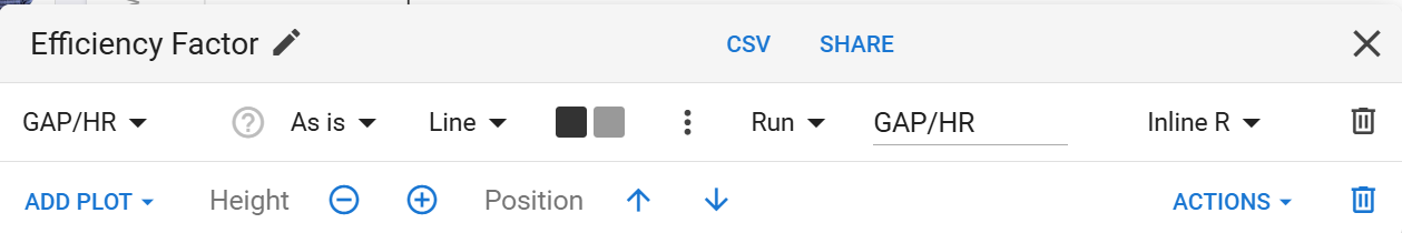

If you are still wondering (or anyone else is), you can do that on the Fitness page with a custom chart.
But isn’t that going to show the efficiency factor for all runs? I only want the graph to show similar runs that are comparable.
Use tags that you can filter on.
