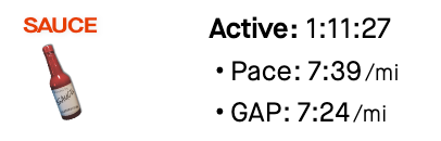

For example, Sauce for Strava shows the GAP for a recent threshold workout the same way that Intervals has it:
Intervals:
With regards to why these paces are different: Strava has a hidden pace of 7:39 for this workout that is based off of total elapsed time instead of moving time (I had my watch paused for about 5 minutes while doing drills), and workout GAP is based off of the total elapsed time it seems. However, Intervals is taking the moving time pace of 7:29 but the elapsed time GAP of 7:24, which is inconsistent. I manually calculated the moving time GAP to be closer to be 7:15 (using the individual lap GAPs on Strava).
IF would be threshold time in seconds / GAP in seconds, and 417/444 yields 93.9 which is close to what Intervals shows (though I can’t explain why Intervals wouldn’t show 94 here instead of 93).
Load is basically IF^2*duration in hours * 100 = 102.9 which matches precisely with the 103 displayed. However, this actually seems to uncover further inconsistency, the ‘duration’ used here is moving time, however the GAP used to calculated IF is the ‘elapsed time GAP’ as I described earlier whereas ‘moving time GAP’ was several seconds faster. The overall impact in load for this workout is only 4 or so, so not a big deal, but that’s mostly a function of my rather short drill session. If I had taken say 10 minutes for drills, my load would have dropped further adding additional discrepancy.

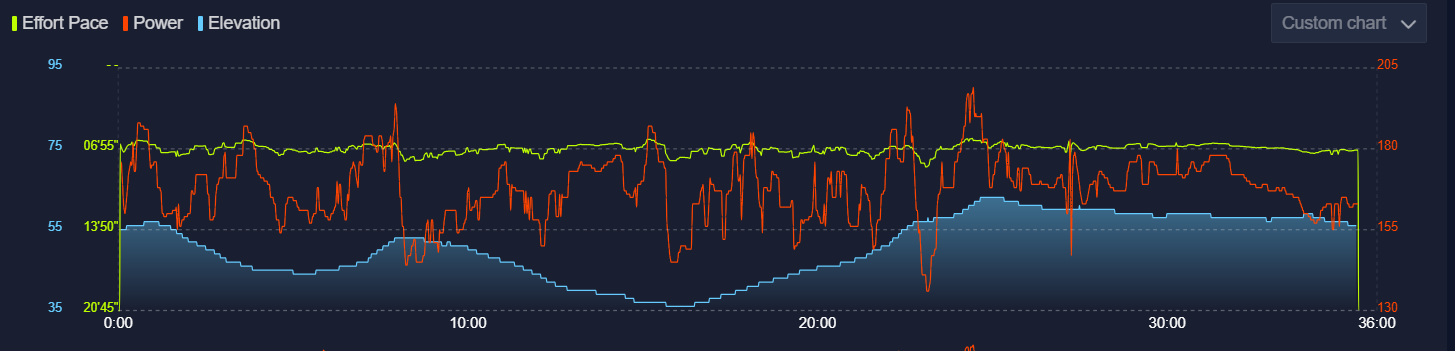

Coros has something called ‘Effort Pace’. The chart follows the one from the wrist power but there are some differences. I have no idea what calculation is behind and I’m not really using it at this time.
@herlas I have, but don’t see the need to drop $250 on a problem that’s solvable mathematically with existing data. Intervals has already implemented a half-measure with Grade Adjusted Pace (against which you can argue, have you considered using a power meter instead?), so why not implement the full measure of GOVSS?
@MedTechCD interesting! It looks like it tracks quite closely to my eye, particularly if you cutoff the first few and last few seconds of the chart so you can see the pace variation more clearly. Based on internet search it looks like something similar to GOVSS/NGP, but haven’t seen the formula for it. But imo supports the notion of implementing.
As soon as I select the Effort Pace chart, the scaling becomes fixed. No matter what part I select.
Hi, the effort pace on coros, is close to the GAP on strava (meaning grade adjusted pace). Its your pace but slightly modified when you are running on hilly terrain. You pace = gap or effort pace when running on a flat course. The purpose of it was to help trail runners to understand and use their pace data when running uphill or downhill to get equivalence. I hope it helps but still not solving the main issue of this topic.
-Marie
Coros clearly states that effort pace is different from GAP. And I know perfectly well what GAP is. Effort pace may be close to Strava GAP but it’s not the same. I can see that in Intervals, because Intervals uses the Strava model for GAP.
I mentioned this in a former post where I included some sources. And I also mentioned that not knowing what it exactly is, is a red flag for me. That’s why I’m not using it.
But GOVVS/NGP came up in this thread and those are entirely new to me. So I just wanted to see if maybe these metrics are related. I’m always curious to see if something is valid/usable when alternatives pop up.
Here’s the post I made on the subject: (DCRainmakers comments aren’t very positive)
