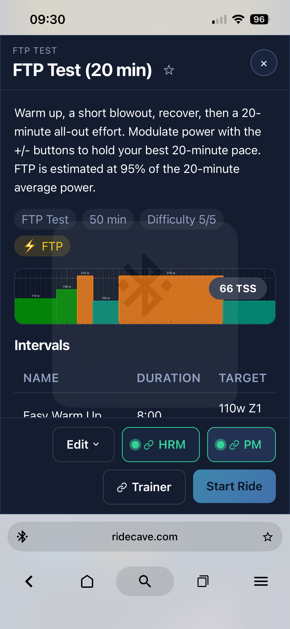

@Marco_Saraceno you discovered the achilles heel of Ride Cave and web bluetooth. Apple blocks web bluetooth in Chrome in iOS so the app does not work in web browsers in those devices. We will likely eventually build a mobile app or bridge app but we’re aways away.
I noticed,… I’ve tried a BLE web browser, and even if it connects to my polar HR belt and the kickr as a power meter, I’m not able to connect the kickr as a trainer… :sad_but_relieved_face:
You can try “BLE Link” Browser - at least it opens the Bluetooth search window for connecting the trainer (that didn’t happen on Bluefy). But didn’t test it myself to connect yet.
Marco can you tell me more about what you are trying to do? Why are you connecting the trainer as a power meter and not a trainer?
Also, what device and browser is that?

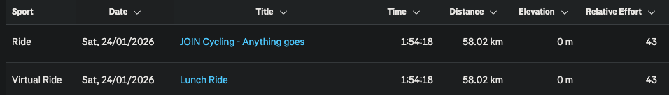

There’s something weird with uploading activity to Strava. This is what I got for today’s ride:
With so many apps connected (Ride Cave, Intervals, Strava, Garmin Connect) it’s possible I have a duplicated syncing somewhere, but I don’t get these duplicates with Auuki so it’s worth checking if it’s possible it originated from Ride Cave itself. I can say Strava upload was in progress FAR longer than Intervals, maybe there was some random error/timeout and auto-retry generated the duplicate?

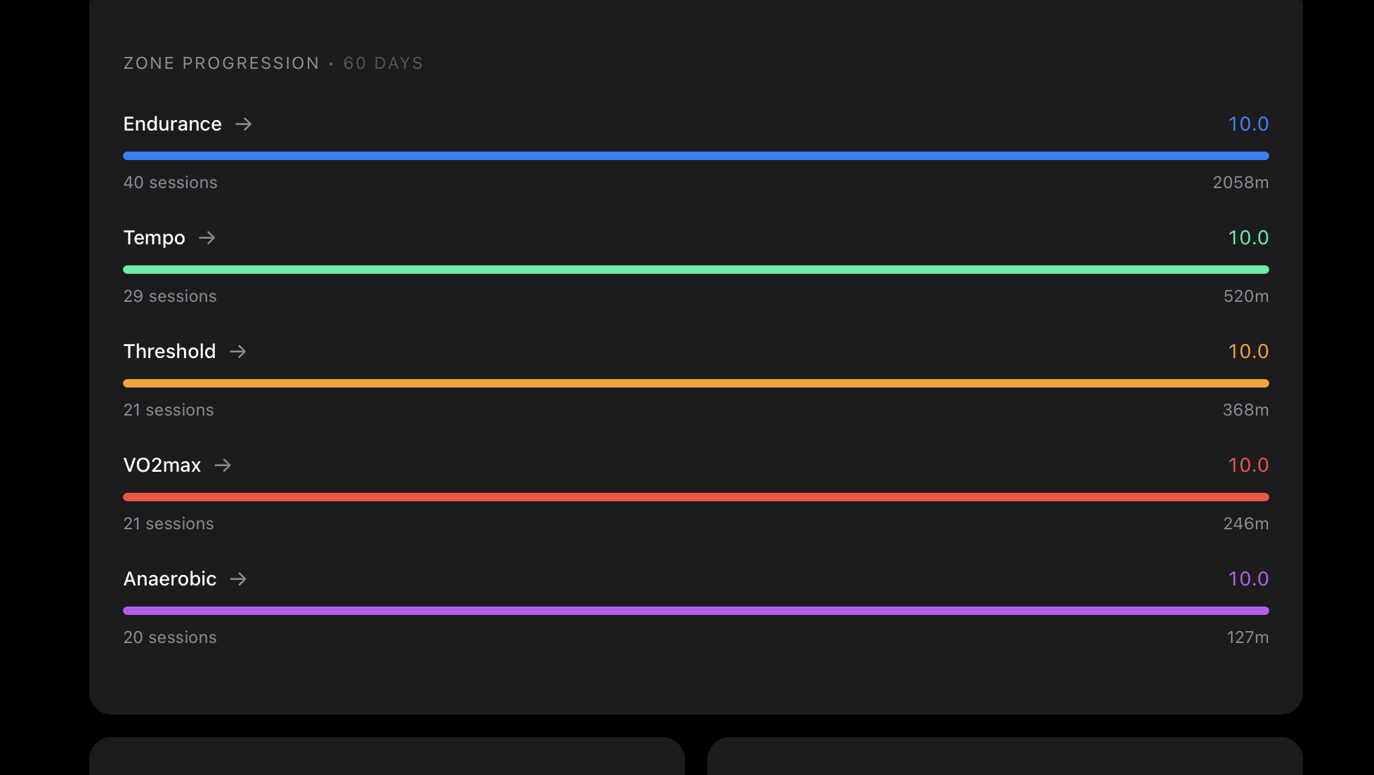

One thing that does look odd for me is the zone progression.

After completing a workout, uploading to Strava isn’t working correctly. The workout is simply detected as a ride. On other platforms, a trainer workout is detected as a virtual ride. This needs to be fixed. Thanks!

I was trying to connect my iPhone running Ride Cave in Bluefy web browser to my Kickr ride setup. Bluefy is a BLE browser that allows to use certain webapp that use bluetooth to connect to a variety of devices.
I connected the PM just to try and it works. Unfortunately when I click the trainer icon, it did not show up the bluetooth selection option, while with both HR an PM I was able to select a device to connect.
I will follow up on R2T trying a different BLE web browser tomorrow when I get back home, and I will let you know.
Thank you for trying this Marco! Let me know what you discover and I can try it out soon too. BLE devices range in complexity while iOS Web BLE (especially through a bridge app like Bluefy, is likely still a nascent technology. I would not be surprised if its able to connect to a power meter as those are very basic bluetooth connections while trainer protocols and GATT handshakes etc are more nuanced and complex.
