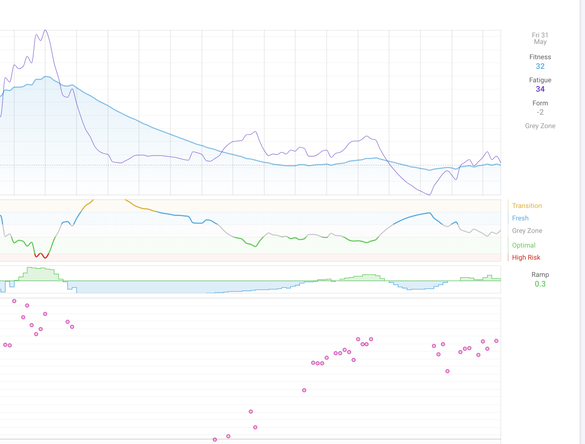

I am 48 yo and I injured my leg in a cycling accident on Feb 26 and I was able to resume pedaling with 2 legs by mid April. During my month and a half without cycling I did arm workouts to limit my loss in aerobic power and towards the end some single leg cycling.
Starting April 11 I was cleared for walking and cycling at limited power, so I started cycling on the indoor trainer with power increasing slowly from constant 100W on April 15 to 140W with intervals at 200W on May 1.
From May 4 to May 14 I took a break from training because of travelling, and then on May 14, I was cleared for training as hard as I wanted by my physical therapist.
I rejoined Trainer Road on May 18 and did a ramp test. Then I started a base plan.

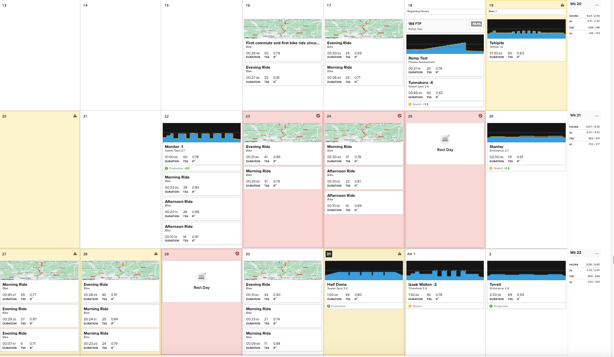

My problem is that I have trouble reconciling the GreenLightRedLight feature of Trainer road with the fitness graph I find here.
TR is complaining that I am pushing too hard and recommending me to skip workouts and take rest days. Whereas on the fitness graph over here, I am “fresh” or in “Grey zone”.
So I am wondering who I should listen to.
Today I was planning to do some sweet spot training, but TR is recommending to switch to an endurance/recovery ride.
I have the impression I am holding back and I am looking forward to riding more. Or should I listen to TrainerRoad’s RedLight GreenLite telling me to take it easy?
If I look at my fitness graph on intervals, I have the impression my fitness is not increasing with my current volume.
Thank you in advance for your advice, and replies!!!

Always prioritize how you feel. Use the tools to guide you and eventually confirm what you feel but be aware that the tools are not ‘exact science’.
And the fitness graph has your pre-injury peak fitness of ~80 which disrupts the view on today’s situation. Fitness is increasing but the scaling is hiding the upward trend.

but so, based on the data on intervals.icu, what would be a good ramp value to stick to in order to get back to my previous fitness without overtraining?

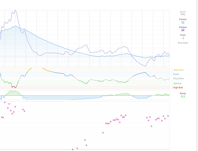

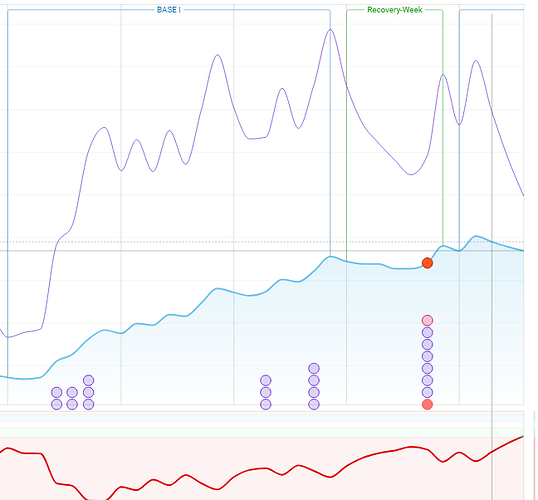

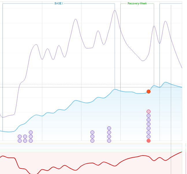

I hope it is okay, if I post my question in here, as it concerns the same topping of comign back after injury and how to interpret the fitness-page of intervals.icu.
I am a 26year old male self-coached XC-rider of roughly 75kg. I did not race much in the last two years.
Last fall I had big plans for the 2024 season - and promptly injured mysel :grinning:. Probably while doing squats (to much to qucikly). I had a nasty infection of a tendon in one knee but was cleared for training in march and have since performed bike-fitting and also lots of physio during the time of the injury. All knee problems are gone (and I hope it stays this way).
Before I injured myself I had a CTL of about 70 points, I could do 368 watts for 20min, 408 for 10min. These were all time best numbers for me.
In March 2024, when I could start riding, I initially just messed around on the bike, having fun and not riding more than three times a week for a month or so. I have now completed my first 3 week training block of Z2 riding (which I did by feel). I did a 20min test in the recovery-week i took after that, coming out at 337 watts.
I have just yesterday started second three-week-block. My form is in the deep red, as you can see. However, i feel fine. Sure, I have had heavy legs after longer rides or the first intervals, but my resting HR and HRV (according to Garmins Body-Battery thing on my forerunner) are fine. I dont want to take any risk reinjuring myself, but my body doesn’t feel like I am donig anything drastic.
For my next three weeks of trainig I plan on doing 2-3 interval sessions a week (Z4 and sweetspot), mixed with lower Z2 riding and strenght sessionaon friday.
Is it plausible to assume, that form is not really adequatley represeting what is going on? For example, with my current fitness of 50 CTL I have a higher FTP than I had a couple of years ago when my CTL was higher.
