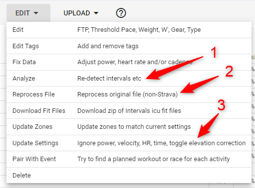

Alternative is to just use Intervals.icu’s elevation correction feature instead.

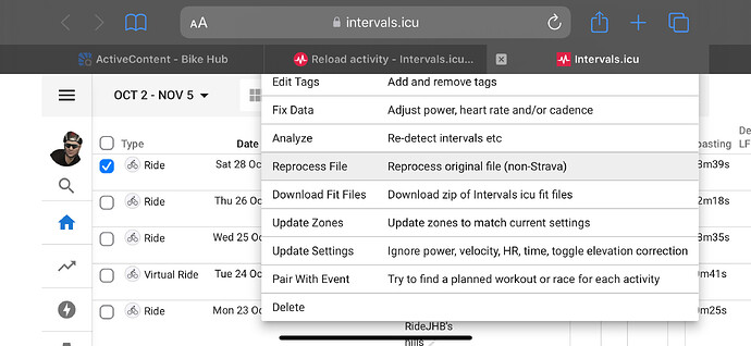

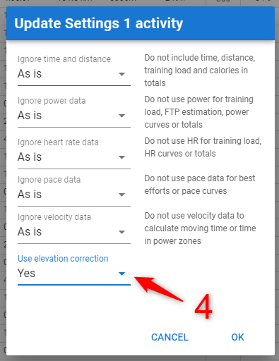

Go to list view,
Tick your activity
Edit
Update settings
Use Elevation correction
Also available in Activity View (for single activity changes)

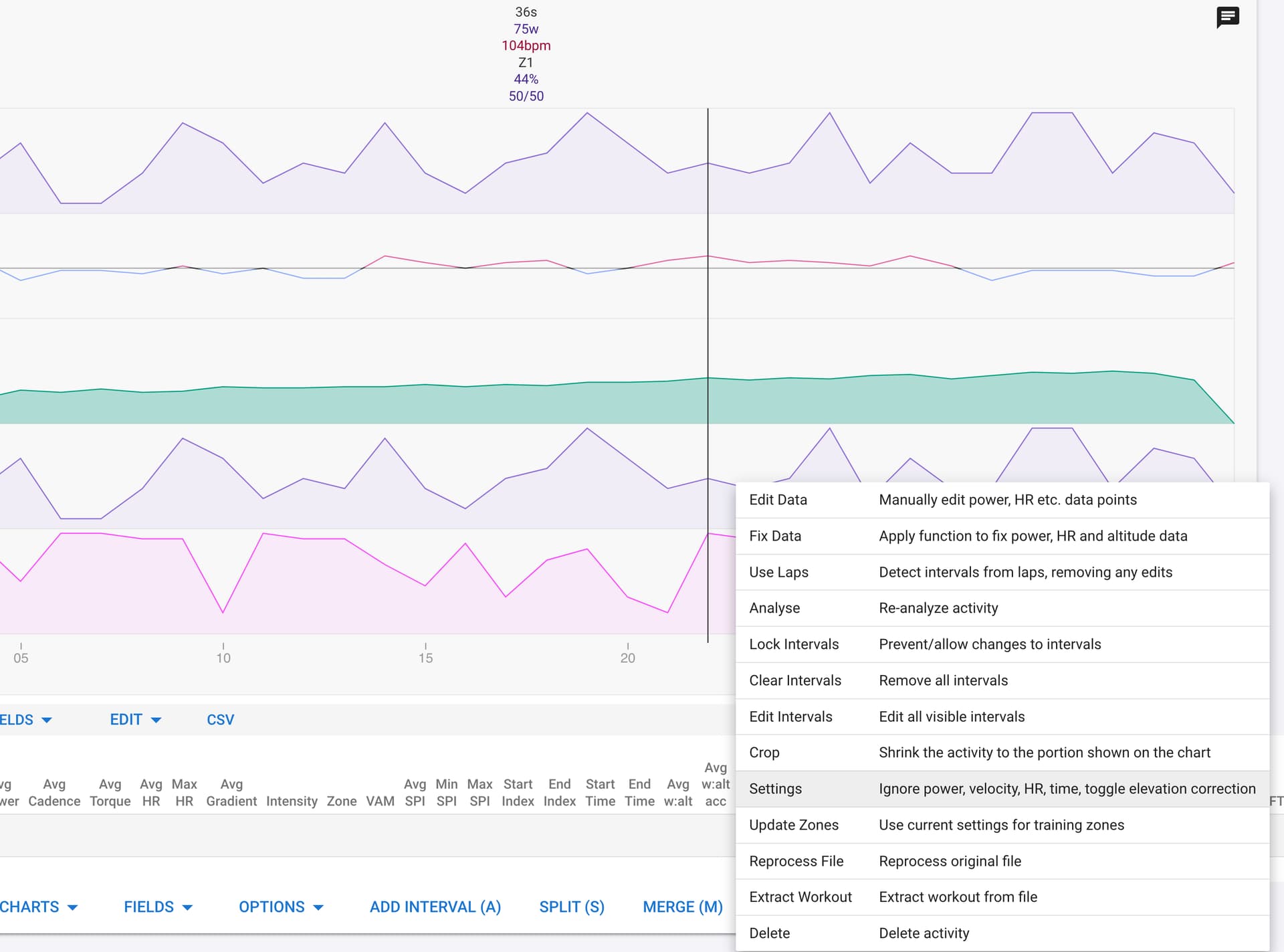

can you share some screenshots of that?
oh.. and I’m not entirely sure if you need to do a “Analyze - Reanalyze Activity” or a “Reprocess File” to get Intervals to ensure it’s using the new setting. Do that if you have not.

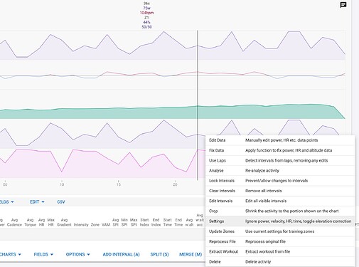

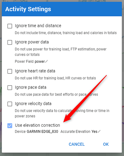

Thank you! Here you are.
No correction is applied…

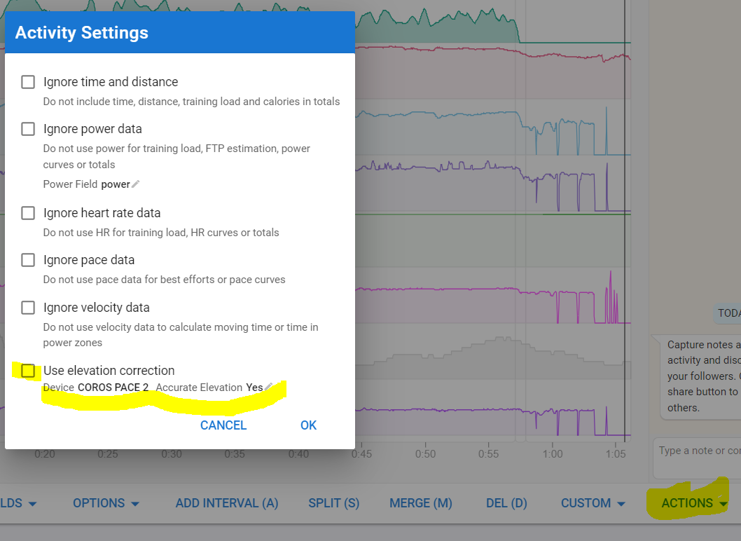

Would you mind checking like this?

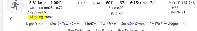

  • open the activity page and check the ‘climbing’ metric. Make a note of it.
  • go to bottom of the activity page, Actions, Settings and toggle the Use Elevation Correction
    You should see that Intervals recalculates elevation and returns another number as the climbing metric.
    If not, your recording device may be noted as not having correct elevation and elevation has already been corrected.

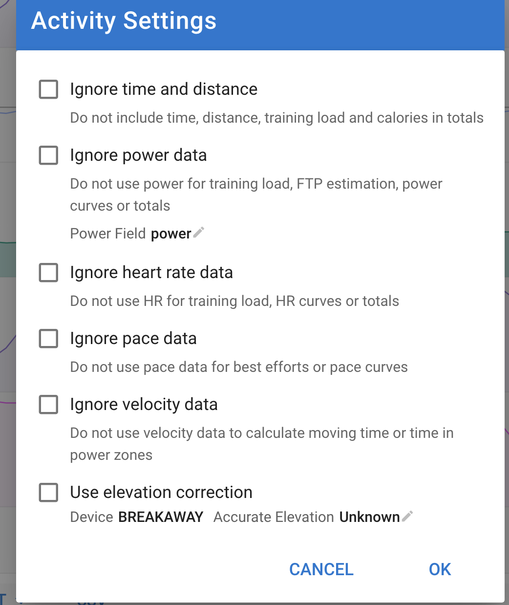

addition to @MedTechCD suggestion, please also share what device is being used to record.

Here you go, nothing happens…
I used elevation correction in GC and it worked. Also in Strava, it got the correct elevation without asking. Recorder .fit file has ~1400 mm, in reality I climber ~3000… funny day out :wink:

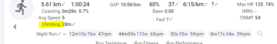

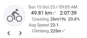

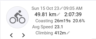

Strange, I would at least expect to get a different climbing metric as in my case:
Before:

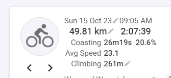

After turning on elevation correction:
BTW: Garmin Edge 840
And another number when I turn off elevation correction again :wink:

can you try it out w/ any other activity files using the same device and see if there is a change in the elevation?
I’m thinking that it’s possible it’s due to this device either not in the Intervals.icu database or something is happening behind the scenes which will need @david to look at

Yes, I do get 2 very different numbers for “Climbing” when I toggle “Use elevation correction” on and off, but nothing happens to the Altitude and VAM graphs. Only Gradient graph changes a lot.
