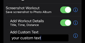

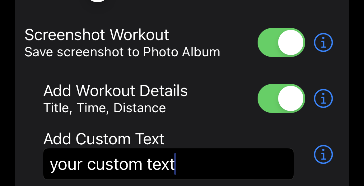

The “blue chart” and whatever other graphic is only available to the “big boys” like TrainerRoad / Zwift / Rouvy and such. Strava doesn’t allow anyone else to do this automatically. In fact, theres not much I can update beyond the name and desc (IIRC) to Strava. I can’t even make my rides private or add gears automatically using their API.
You can however, upload the chart manually.. There is an option to within “Advanced Settings” that will create a screenshot of your workout and you can also add some custom text.
