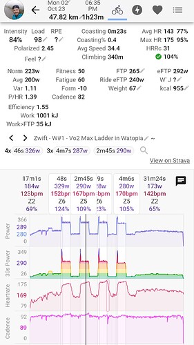

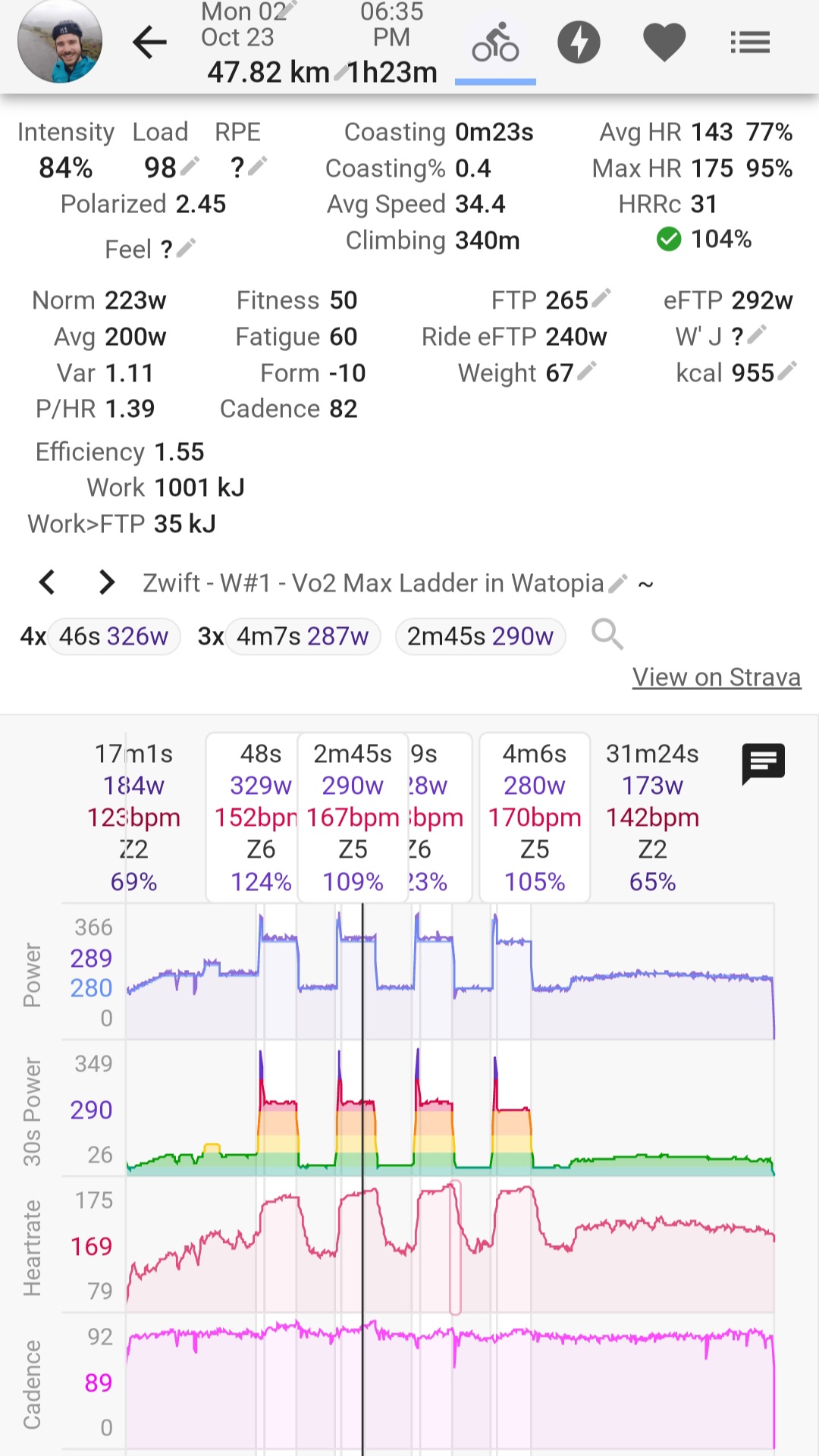

This was the 4x5m I did last week. For this week I have planned a similar one, but with 5 sets instead of 4
The extra interval will build capacity, that’s good preparation before increasing wattage.
