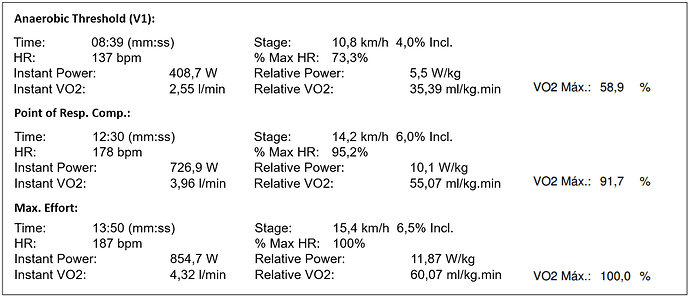

Hey guys,
so last week I did a ergospirometry test where the results are presented bellow:
How should I define my HR training zones according to this result? Does the V1 Value should be the top of my Z2 (Joel Friel 5 Zones)? Cause it doesnt match with what is calculated for a LT of 178bpm…
Thank you!
In your screenshot, V1 is called anaerobic threshold, which is MLSS/LT2.
However, your heart rate is 73.3% of maxHR, so V1 looks to be your aerobic threshold; they appear to have labelled it incorrectly.
So V1 would be the top of zone 2 as you have asked.

But I still not understanding it. As I mentioned, if I use any of the HR Zones calculation methods (Joe Friel, MyProCoach, etc.) my Zone 2 is way higher than the value above…

??? The power values imply an FTP around 600-650W. Shouldn’t anyone with these kind of values be followed by a pro team?
Where do you get 600W?
An ergospirometry test is a ramp test to exhaustion with the purpose of eliciting VO2max. AT/FTP is very roughly about 75 % of max power.
Unless this was another protocol?
That was made on a Treadmill, not biking :stuck_out_tongue:
The way I interpret is much the same, i.e. +/- 75% of peak power is a proxy for FTP.
The V1 heart rate appears to be inline too, at 70-75% of maxHR.
However, a (relative) VO2 of 60.07 seems a bit low for the watts produced.
I’m wandering too what the testing protocol was.
How were the watts captured? What device?
It was a Treadmill.
