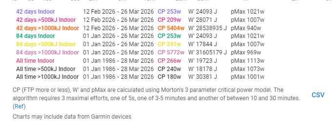

Hi, I have started to track my performance after certain kJ. I don’t understand though why my numbers looks so odd at >1000 kJ. Anyone have a clue?
