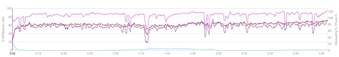

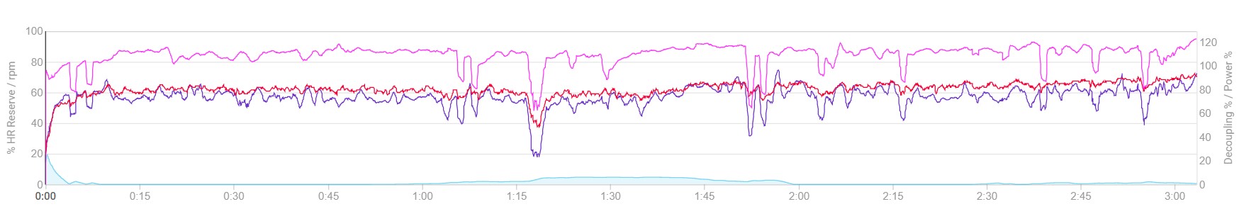

I attached a picture of my 3h indoorcycling from where you can see how heartrate stays nicely 120-125bpm, but watts are drifting up and down.
There are also quite a lot variance in cadence, but heartrate stays still in 120-125bpm.
In the end after 2h45min heartrate starts to drift up too much and i needed to stop riding.
Also decoupling stays low except after that 3min drop after 1h16min. I don´t remember reason for that drop, but it is not relevant in this case.
Someone wiser could also answer for Dave if I´m totally wrong.

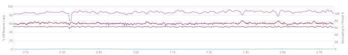

Here are also my 2,5h indoorcycling with 160W where watts are quite smooth, but heartrate varies from 115 to 125bpm and cadence are also not so smooth.
Maybe these gives you some advise for riding with spinningbike.
