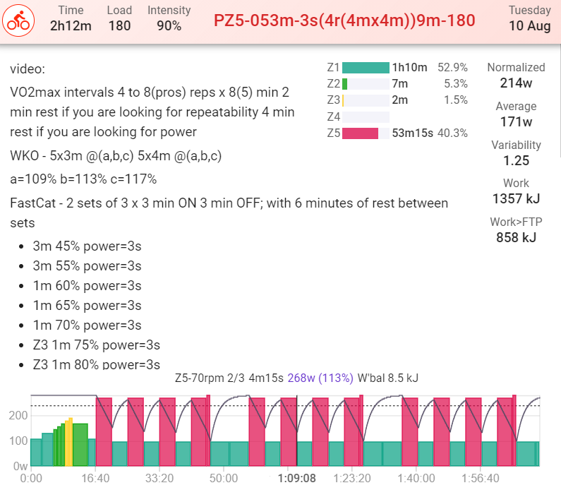

Simple question: What’s the max Z5 time recommended for a week at the most peak of the training plan (let’s say the week before Peak phase starts)?
I’ve seeing a lot of 5x5m to be very hard but…
It happens that I’m in a week of about 600 TSS (10 hr) and the TID asks for 18,9% at Z3(Z5+Z6+Z7).
Man, we are talking about 113m in a WEEK! almost 4 workouts with 5x5m at Z5 or above.

That is to much time in Z5, it has no benefits!
Btw, the workout done isn’t correct with the plan. The plan says 3x3min rest 6 min and repeat 3x3min. You did 4x3, rest, 4x3, rest and to finish 3x3. Too much Z5 is detrimental, not benefitial
