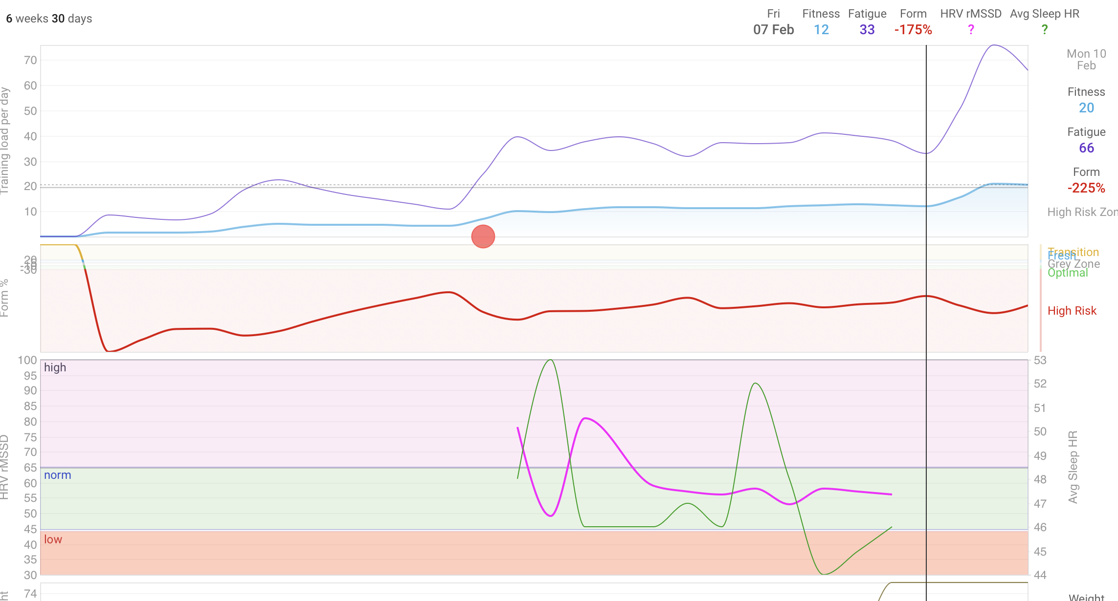

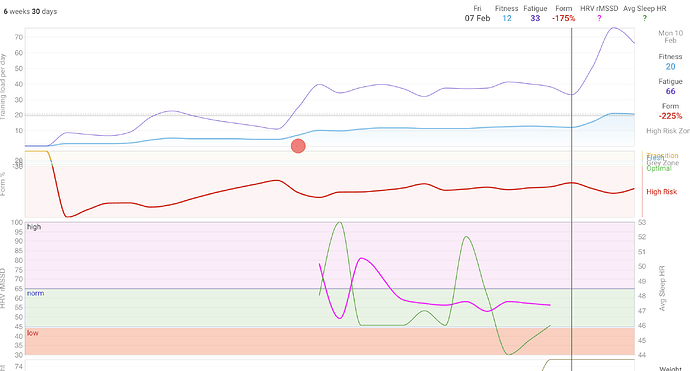

new Polar (and infrequent Intervals.icu) user here. Would like to track overnight HRV and HR on the fitness chart but not getting consistent updates.
I connected it last week and the first import was good, but then this data stopped coming in (activity data is still importing fine).
Tried to upload all Polar data but this didn’t impact the dashboard.
Any tips?

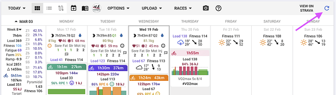

is the data available in Polar Flow? have you tried disconnecting your Polar account and then re-connecting?
i’ve found i need to click the refresh icon (Look for new activities) for the Polar HR info to show up in the Activities page.
