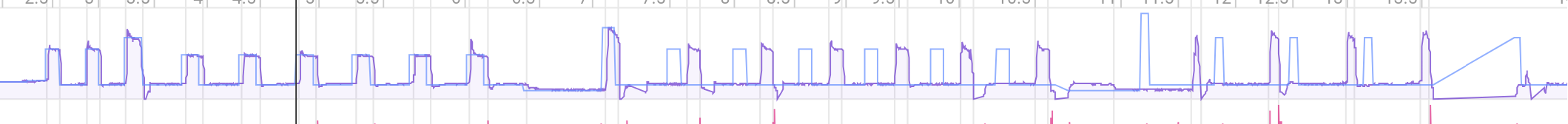

The power, heart rate and pace charts on the activity timeline chart now show traces from the planned workout when one is paired:
You can adjust the offset in “Options” (“Workout” slider) to get the planned workout to lineup with the actual activity:

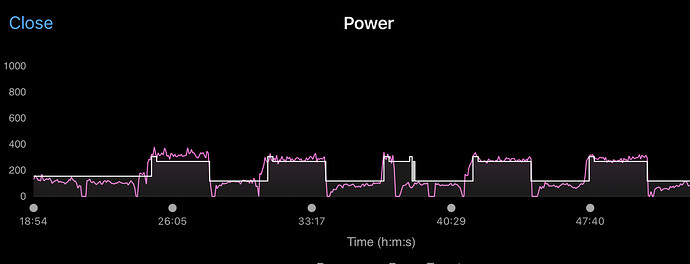

Sorry to bump this old announcement, but it seems this does not handle pauses very well.
I did a workout that was rather high in spikes and needed some unscheduled recovery time to gather myself :skull: . The planned power keeps going over the time where my HR is still being recorded but my workout self paused due to lack of cadence.
I mean, the workout didn’t go as planned, but it would match up more than it looks if it took account of pauses.
Well, you didn’t follow the workout as planned. It shouldn’t magically say you did.
It’s okay to not go exactly to plan! Just don’t ask the software to lie about it :slight_smile:
sure, but it would be nice if we could toggle a “update target workout with as completed” because some pauses are inserted on the road to align with terrain and traffic (and have no impact on workout intent).
While I appreciate that it’s not exactly what was planned, I think it’s fair to re-align based on moving time, that’s not asking it to make up data but rather align on a different but non linear time (already used for a myriad of other metrics in intervals.icu). I still completed the workout, and as noted above there can be reasons to not be moving but still overall be doing the structured workout.

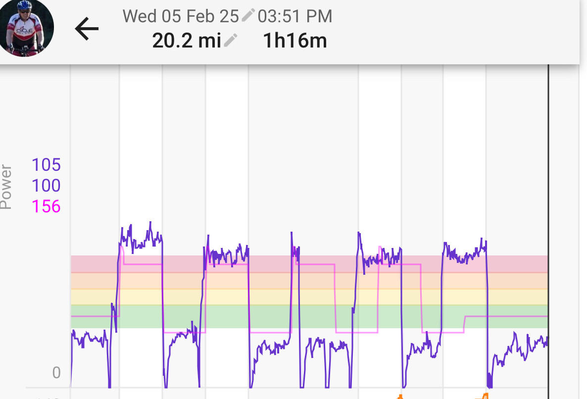

That doesn’t work for me. Here are some 4x3-min(3m) intervals interrupted by construction:
And intervals

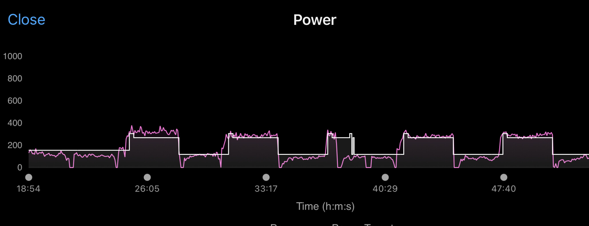

Garmin shows target as completed, including where I messed up the rewind during the aborted 3rd interval.
That does not seem to affect the offset of the workout after a pause in the activity, as shown below.
Pause hidden:
Pause shown:
I admit… I do not know how this works or whether it works (for your use case). I guess it doesn’t work.
I don’t pause my workouts, so. I do not have the same experiences as you. (I only do my structured workouts indoors)
You can’t do what you’re after because the Workout plan is inserted as a fixed stream.
You can only move the whole stream left or right.
