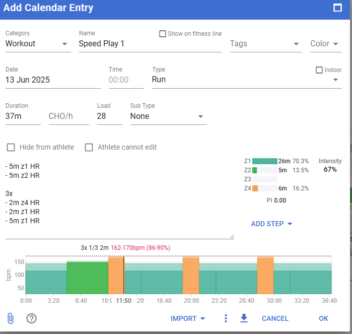

I spent a good few hours the other day uploading 112 workouts from 80:20 the other day and i am using the program without issue.when i created the workouts they were all created in terms of heart rates zones ,
for instance
-5m z1 HR etc

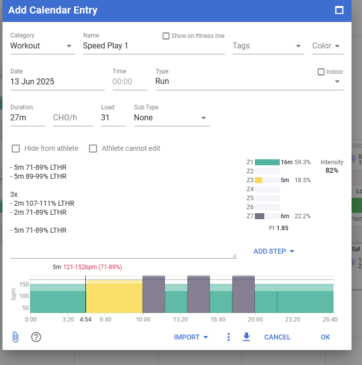

However when ive assigned these workouts to one of my friends they have all come in based on LTHR and are totally changing the workout , why is this ?
The percentages dont seem to marry up, is this because hes using a different heart rate zone system ?
Has anyone got any idea why this is occuring .
I’ve set up all these workouts based on heart rate zones .
However when I then assign them to someone im coaching it does not use their heart rate zones which is causing issues .

The workouts were created inside of intervals based on HR zones .
The workouts are all saved externally as FIT files based on HR Zones .
I upload the files to each user an for what ever reason the HR zones disappear and it uses much higher zones , I am assuming that’s based on my own but I can’t see why it would do that .

I would go back and do this but there’s 168 workouts and I have two of my friends I’m doing this with .
I don’t understand why this would happen they are specifically set at
-5m Z1 HR
Etc
Surely that should change for each user
