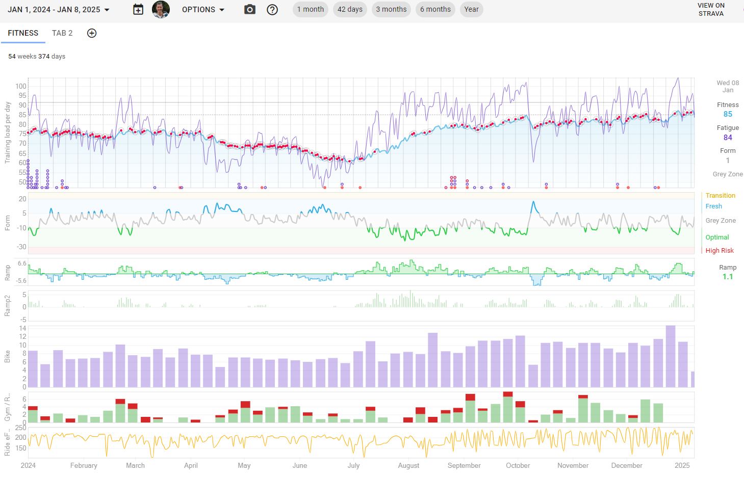

I am not training for any event. Just try to continueously getting stronger/faster on Zwift. My current fitness score is 87. Goal for 2025 is to improve my 20 min power with 10%, if possible (now at 4.17wkg)
Based on my fitness-chart, trying to figure out “periodic rest weeks”
  • How many days/weeks should such a period be? or
  • If my fitness is now 87, should I train light until I get down to fitness score X? is that down 10% or when have I rested “enough”?
I understand the value/importance of rest but since I find it very boring, some metric/value would help/inspire me to get the rest done :slight_smile:
Thank you
