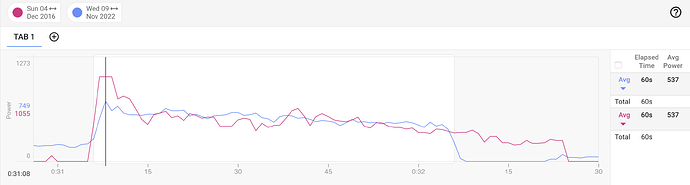

Sitting in a meeting at work, been wanting to try the compare feature…

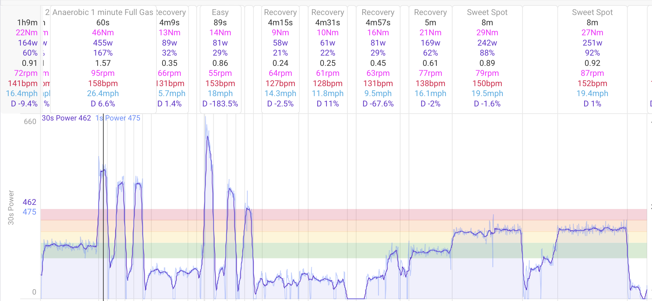

Here are my two best 1-min efforts. First from December 2016 Group Ride, the second from a coach assigned November 2022 workout:
FTP of both around 265-275W. Ended up at 537W for both.
Group ride there were 2 or 3 of us racing up an overpass. Its in red above and you can see a longer tail past 1 minute.
Coach workout - told to go “full gas” which is max repeatable (nod to @FerrisFast)
clearly I “failed” to follow instructions on the 2nd set

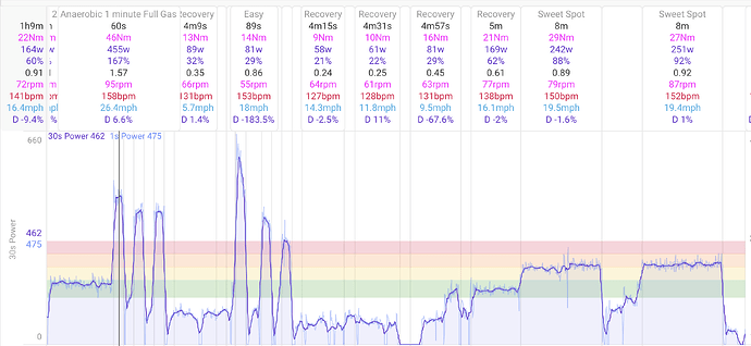

First set, first interval I managed 455W evenly paced. Max of 522W.
Second set, first interval I pushed out a “controlled hard start” with peak of 749W.
Coach comment:
550watts!! not often I see over 200% for 1min! Not a bad way of coming off of being injured
he used TP reported interval NP in that comment, it was a little higher than Average Power.
FWIW. Everybody is going to find their own pacing, thats mine.
