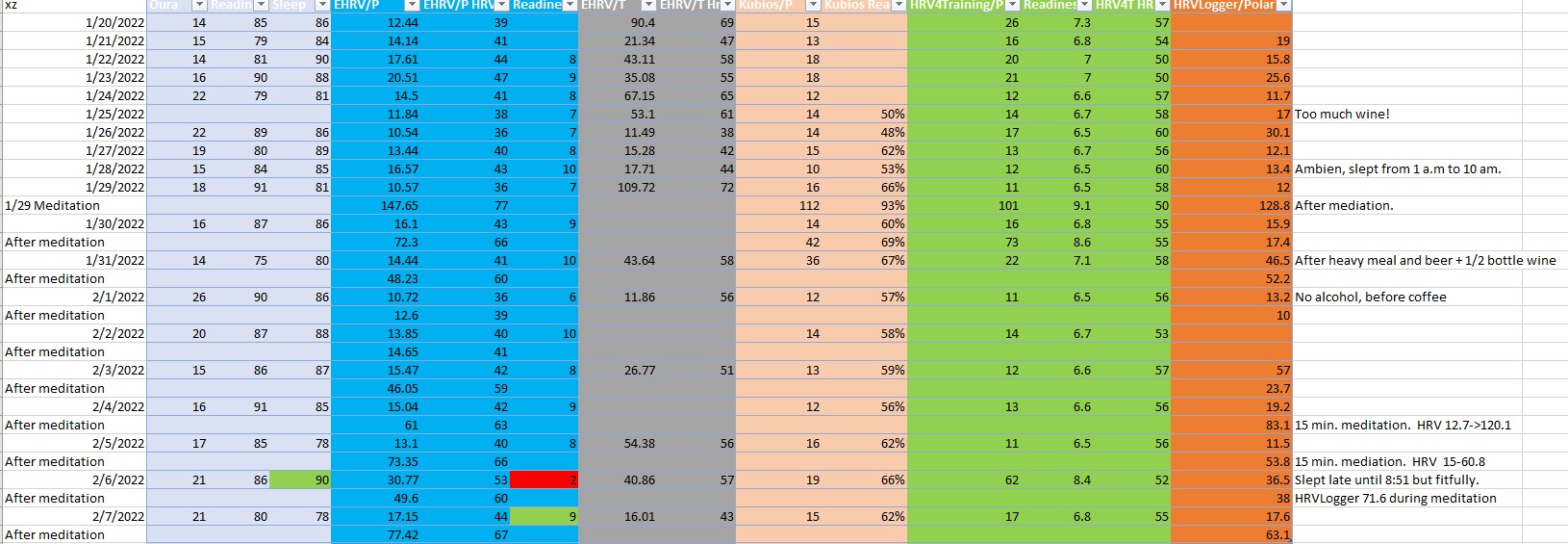

I’ve been using an Oura ring, V3 for over a year. Prior to that, I used three different apps (Elite HRV, HRV4TRaining, and one more I forgot) to take morning readings with Polar H10. Oura takes an overnight HRV reading automatically, which is part of the “readiness” metric. Based on the sources I found, taking a reading during the night is very accurate, but I wanted to check so I did a month-long comparison of overnight Oura and the three morning readings. The result was that the Oura overnight reading tracked along with the early morning readings, so I know just use the Oura’s reading and don’t bother with the apps.
No discrepancy as described by Marco Altini?
With the overnight readings being influenced by late evening stuff like late dinner, workouts, alcohol?
I could definitely see a difference in my sleep quality score from late dinners and alcohol - and to a lesser extent in readiness. I didn’t notice much difference in my HRV that I recall. I’m 70 years old and my HRV is relatively low, ranging from teens to around 30ish. At the risk of boring you, I’m attaching the working spreadsheet that I kept last year. HRV comparison|690x239 As you can see, if I waited to record HRV after a morning mediation, my HRV was much higher.
interesting. And since I can’t get those Sessions to work in the morning anyways, I’ll try manual readings using the Oura Ring until the end of the week, and should that not work, I’ll just give the night readings a try and capture some month or two of nightly Oura Readings VS. Morning Elite HRV/Polar H10 to see how and if they differ.
