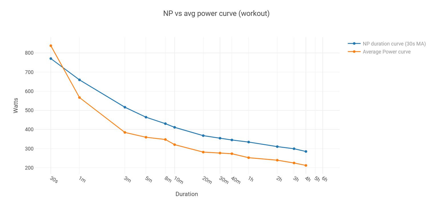

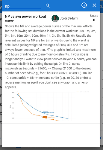

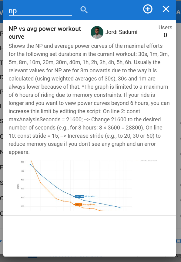

Hello I’ve just coded a graph to see the NP curve for a workout and made it public if you are interested you can find it looking for this on the activity charts (power section of a workout): np vs avg power workout curve. Should be open to everyone, tell me if you want it and can’t find it!
Also tell me if you find any issues with the readings, I tink it works well but I haven’t done a lot of testing, thanks!
