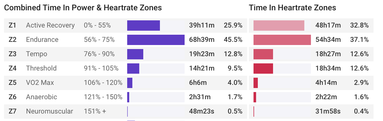

Tx. You should probably just adjust the Intervals.icu HR zones to more closely match the Strava zones, at least for the lower zones. In particular make the start of Intervals.icu Z5 match Strava Z4 i.e. 206 bpm. HRSS looks at HR relative to threshold so that will help a bit.
Intervals.icu uses a 7 zone model to match the power zones so a mix of HR and power activities can be combined for “time in zones” totals and so on. So you want the power and HR to match up if possible.
Here is my year so far … the power and HR bars are very similar which is what should happen if everything is setup nicely. But maybe your HR response is just unusual :slight_smile:

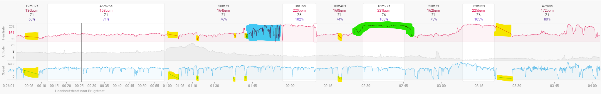

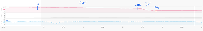

Yellow zones: stops - blue zone: some strange spikes, so probably bad connection of HRM, green zone - see below

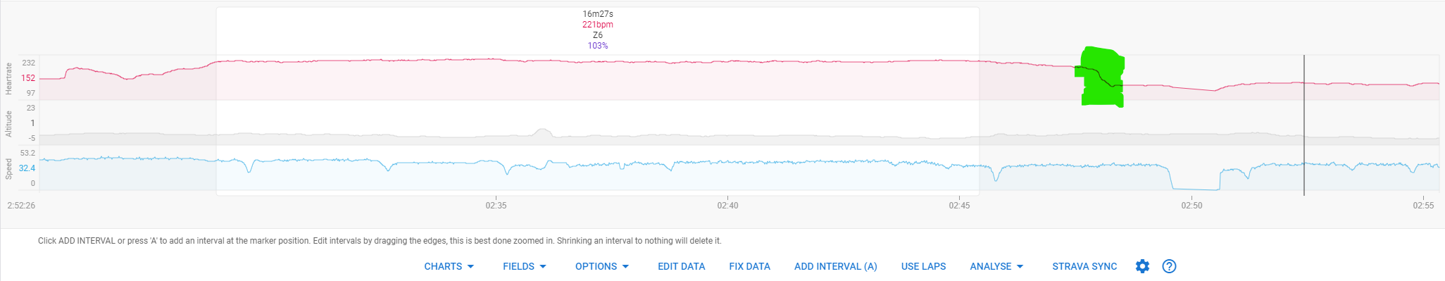

30min interval (green)
5min crop - we drop the pace from 35kph to 30kph at the beginning here.

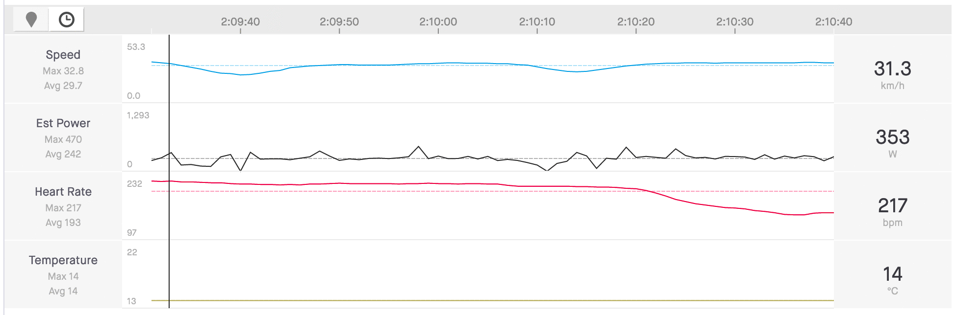

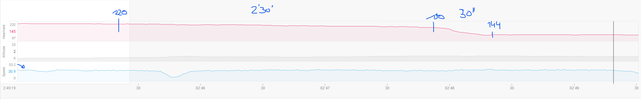

1min later, my HR starts to drops gradually from 220 to 190 (takes 2min30), then it goes to about 145 in 30sec. I have no idea if this is normal behaviour, but I don’t see any jumps in values in that whole area. And I was certainly recovering at that stage of the ride. At the 3h zoom level, this looks very steep, but zoomed in, it looks alright to me… At the stops and the spikes I can see the irregularities when zoomed in.

I have the medical letters after my name (not that it makes any difference) and without going into details, the only real-appearing HR data I see are from about 0:10 to 1:00, 1:05 to the blue highlight, and maybe from 3:30 to 4:00.

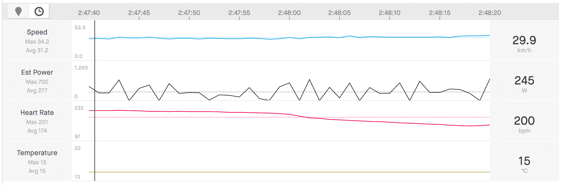

Okay, because I can’t help myself: see these three zoomed in sections, where your HR drops > 60-70 beats in under 30 seconds, without speed or power changing (I managed to pick one point where you actually had 0 power, probably due to a Strava calculation).
Plus, there are numerous sections that clearly show equally unexplainable jumps, but you recognized those as spikes.
Given these irregularities, my guess would be a HR monitor acting up, but once again: if the doc says it’s fine…

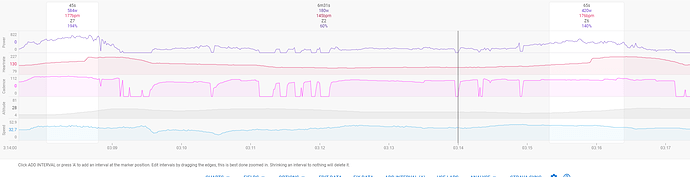

did a couple more rides. On one indoor ride with some sprints the max HR on the Viiiva was 168. Next ride you can see some obvious jumps from about 170 to 200+ values.
4iiii will take the unit back. I’ll look for a way to delete the HR data here from my earlier activities as they will probably mess up my data.
