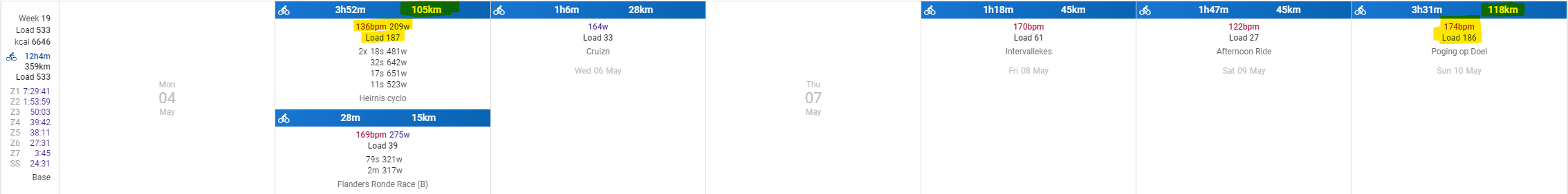

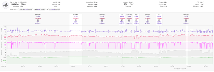

There’s a problem with my race bike, so yesterday I took the gravelbike for a ride with a (well-trained) friend. When I compare the training load of that 118k flat-out ride yesterday (186) with the load of an really easy 105k on Tuesday (187), something is clearly not right.
Average speed 27,3kph vs 33,8kph, avg HR 136bpm vs 174bpm, distance 105 vs 118.
I would expect the training load of my last to be double that of the first one (felt like triple the load actually), although I’m not familiar with training load calculation tbh…
Most crucial difference is obviously that the first ride was with HRM and PM, second only with HRM.
I spent considerable time around 220bpm, which is above my lactate treshold for sure, based on a max HR of 236). Anything I can change in my settings to get the load more in line with the HR data? I hope to have my racebike with PM fixed asap. But when I ride gravel, I use the other bike anyway, so it would be nice is if the training load based on HR was a bit more reliable…
Is that even (humanly) possible?
As to the load: there may well be a difference in calculation if your normal rides are with, and this one is without a PM. However, that would normally not account for such a difference, but @david is the guy to explain this…
Okay, so…

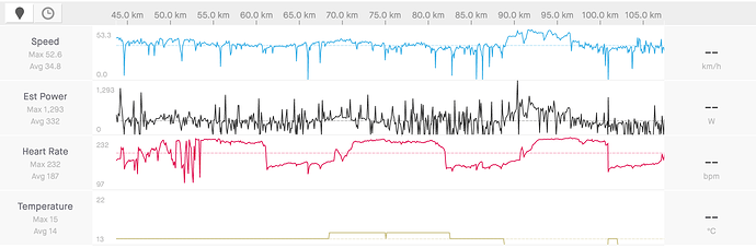

On Strava, your ride shows wild jumps in HR that cannot be explained by the change of pace (speed) or terrain (it’s flat). It jumps from 140 to 220 instantly, or the other way around - it may get ‘stuck’ when it is spiking, I’ve seen that on mine sometimes. Also in the low spectrum, where I am blowing up, but my HR monitor is stuck on 85 bpm…
If you take those out of the equation, your average HR is still higher than the Tuesday ride, because of the higher pace, but depending on how much you drafted off your buddy, not that much higher.
Furthermore, Strava calculates an estimated 313 Watts NP for Sunday’s ride, against a PM based NP of 189 for Tuesday. Obviously, had you used a PM on Sunday, your NP would have been (a lot) higher, but I do not think you can produce over 300 Watts for 3 hours, or do you know you can?
Your Zwift race in between had a NP of 270, but that was only 28 minutes. Also that activity shows a weird HR spike halfway btw.
Maybe your HR monitor is acting up (batteries, poor contacts? Which HR monitor is it?) and maybe intervals.icu takes out the spikes when calculating load on HR based activity.
Still, your Sunday load should be higher than your Tuesday load…

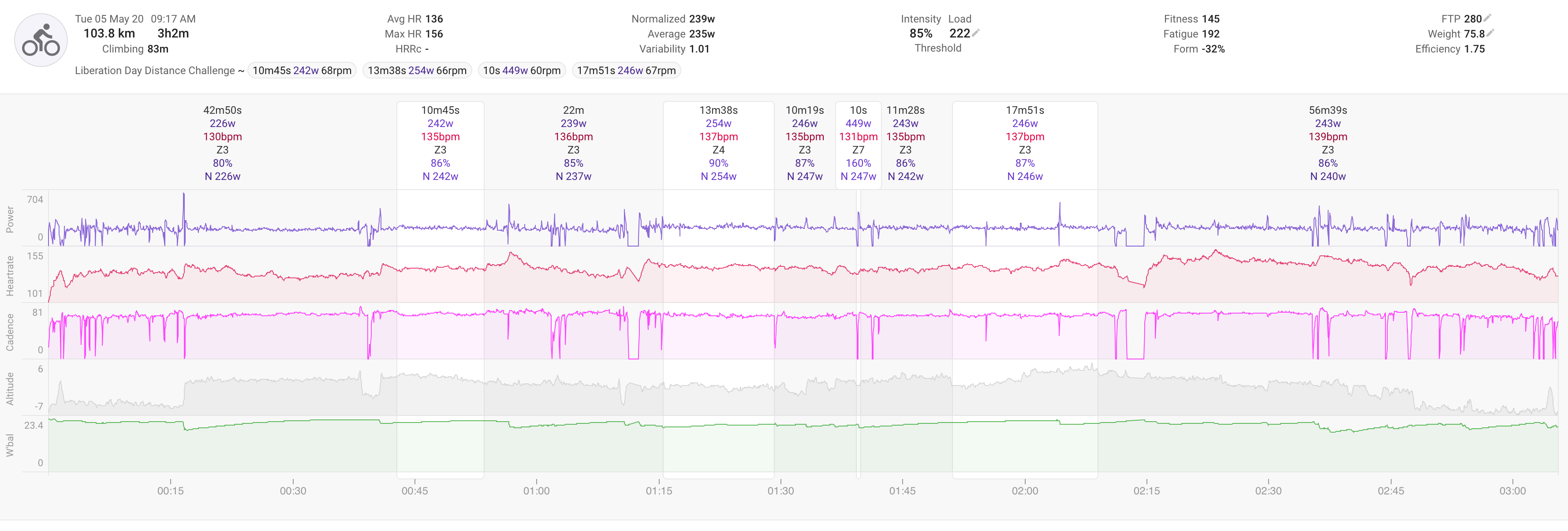

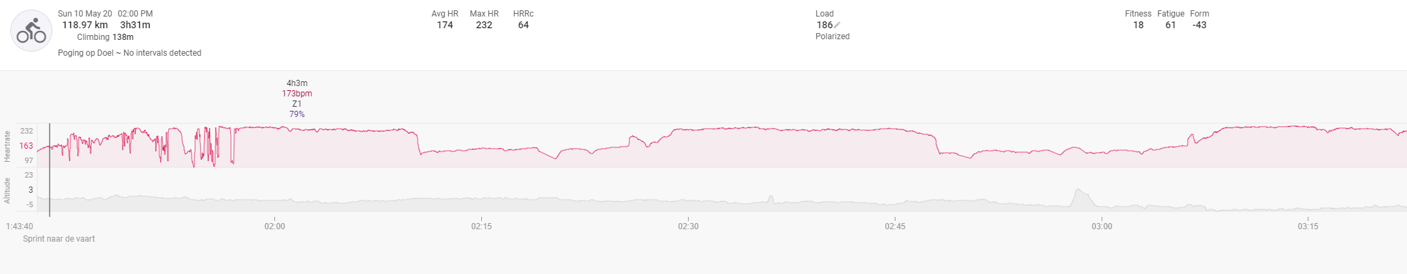

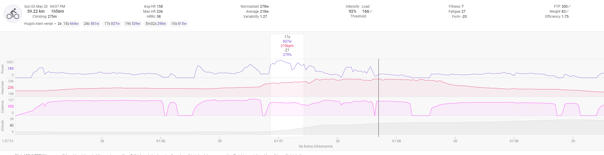

screenshot from 1h40 until 3h10 in the ride

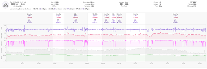

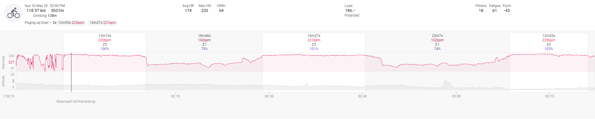

and here with interval zones of about 220bpm - in blocks of 12-16min, which seems to be how long I can go at this pace (bpm and time depend a bit on where you start the interval of course).

PS And you can see the wild HR variations/jumps in your screenshots - that’s not normal.

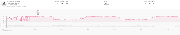

These are 5min from my first ride with HRM and PM. Full on sprint on a short 38m altitude climb (with some turns as you can see from the cadence)
HR goes from 150 to 236max and back in 5min. If the HRM was wrong, that curve would probably not as gentle as it is? But definitely high enough to get a test to check if all is well.

The zone with the spikes was where we changed course as we were in the middle of heavy showers. My mate was looking for another route, so we stopped frequently, then went full out and stopped again to find the way. So GPS went to pause and restarted with a lower HR maybe? Maybe I had a bad contact too as in one instance it seems to drop to half the rate and then back up. But that’s the only place I can find in which the HR data don’t match what was going on on the road.

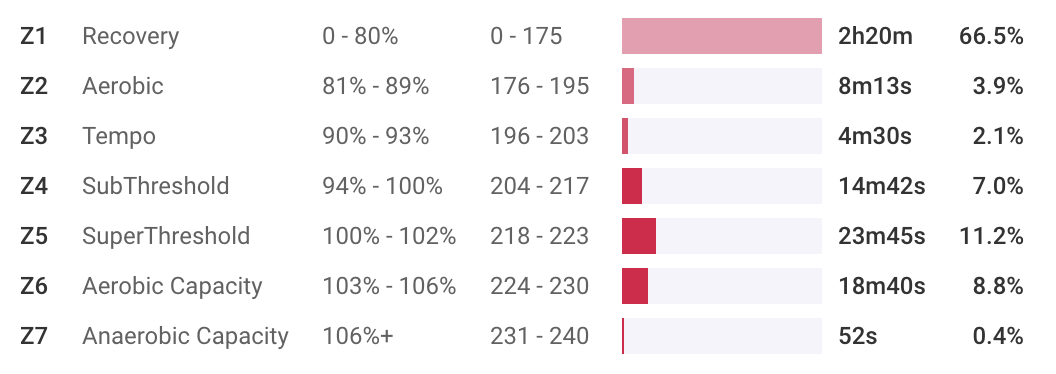

I think your HR monitor is acting up a bit as @Cyclopaat suggests. If you look at “time in zones” for that ride you spent 66% of the time in Z1 which isn’t likely for a tough ride.
The load has been estimated using HRSS (normalised TRIMP) but none of the models are going to give you high load with so much time in Z1.

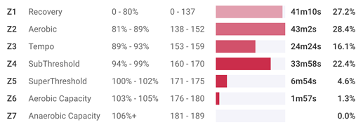

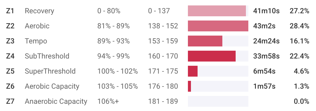

By comparison here is my HR zone plot for a 2h31m 177 load ride:

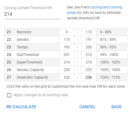

I think the heart rate zones calculation might not fit my heart well… I’ve just change my lactate treshold (214) to fit my max HR (236) exactly. Was at 221 - 240, so too high.
That helps with the zones already. But my recovery zone is still way too large I think. (0-172)

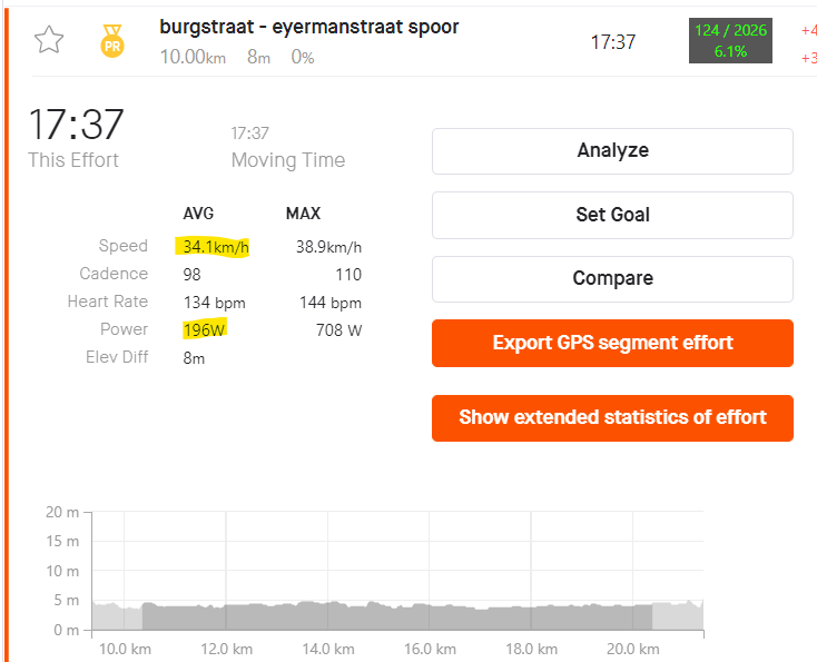

Early in the ride, we rode a long straight segment next to eachother at 34kph. This is from my friend’s strava:
Almost 200W. I had a average HR of 154 on that segment - probably for +200W (he’s a bit smaller and has more drop). I’m not fit enough to consider that recovery… That’s middle of zone 2 in the power zones. Are power and HR zones supposed to correlate?

I’m really curious to see your test results - LTHR at 214 and Z1 up to 172. I can’t even…

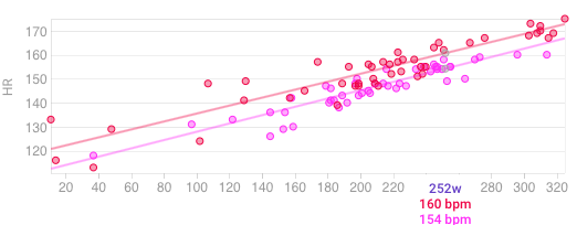

This is interesting. My max HR is nowhere near yours (188) but 150-160 is where I am at riding tempo power. The “time in zones” load estimation model might work for you but you need quite a few rides with power and HR first.
Screen Shot 2020-05-11 at 20.40.10
Ok! So the algorithm will recalculate my HR zones over time to match my power zones? That’s great!
