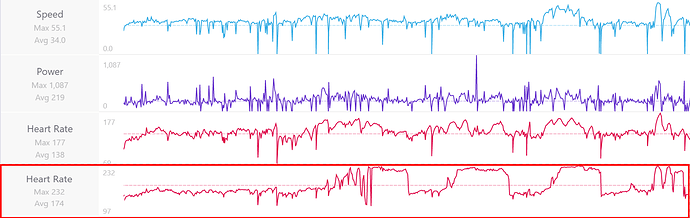

Note quite. But it will learn a training load factor to apply to time in each HR zone which should produce better HR load estimates.
Hi Eric, I’m not sure what you mean. Are you referring to record as in ‘world record’? Or record as in registration?
Sorry. I was referring to the HR trace you showed. As others have pointed out, HR data don’t look like that.

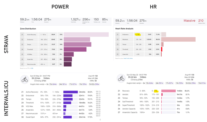

@david I just had another look at the one outside ride with PM and HR and compared the power zones and HR zones from Strava & intervals.icu. Warmup, tempo & treshold, some short climbs at full intensity and cooling down. Quite a diverse ride.
Every HR zones model probably has its strengths and weaknesses. But it seems that the model you are using is really broad in its zone 1. Strava only uses 5 zones instead of 7. And zone 1 in your model is almost as broad in range as zones 1 and 2 in strava combined…
In the power zones, I spent about 50% in Z1 & Z2 and 50% in Z3 and higher (tempo and more)
Strava HR - 80% in Z2 - 9% in Z3 and above
Intervals HR - 87% in Z1, 8% in Z2 and only 5% in Z3 and above
I’ll rest my case if the info is not really useful to you. It’s just good for me to get to know the data and models, and understand how it works. And I thought you might find it useful as well. As this is free software, I’m certainly not complaining. Having my own HR zones tested will probably solve most issues. But it might be worth having a look at the default distribution of the HR zones and comparing them to other models like the one strava is using.

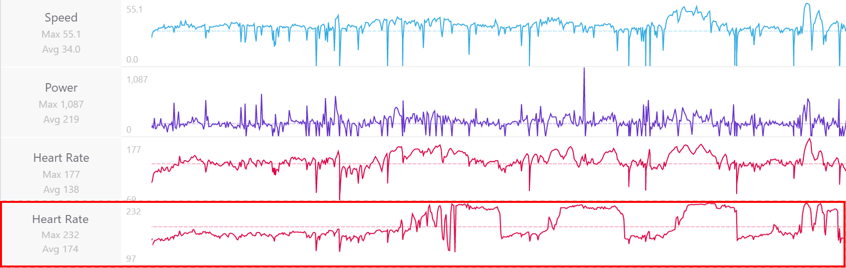

Just compared it to my friends data on Strava. My HR is below, the rest is his data.
First part is similar. Then there are some spikes, which are a lot more pronounced than his. Might be an error in the HR reading, might be my heart - no idea. Certainly looks weird. Then you see three high zones (220 average). We were going all out and taking the lead one by one (the spikes in his power). At a certain point I have to draft, until I think it’s time to get my HR down because we still have a long way to go. So he slows down from tempo/treshold pace to endurance, which gets my HR down to about 150 in a couple of minutes. We keep the pace a little bit lower until I’m ready to go all out again. Then HR goes quite fast to 220 again.
Mind you that he’s fitter than I am, so I really have to give it all I have to keep up.
It’s not that my HR is stuck at one value for a long time, it really fluctuates a couple of beats. But it stays within that high zone and then drops quite fast at a recovery pace. The data I see during the ride or in the curve could be flawed because of the HRM, but I don’t really see how. I rather think that’s how my heart works. But will double-check with another HRM and some medical testing…

Tx. You should probably just adjust the Intervals.icu HR zones to more closely match the Strava zones, at least for the lower zones. In particular make the start of Intervals.icu Z5 match Strava Z4 i.e. 206 bpm. HRSS looks at HR relative to threshold so that will help a bit.
Intervals.icu uses a 7 zone model to match the power zones so a mix of HR and power activities can be combined for “time in zones” totals and so on. So you want the power and HR to match up if possible.
Here is my year so far … the power and HR bars are very similar which is what should happen if everything is setup nicely. But maybe your HR response is just unusual :slight_smile:
That makes sense, but your legs will give in, not your heart. Honestly, that HR does not look as real to me. You may well have an unusual high max HR for your age, but 236?
And you mention it ‘gently’ increases or drops, but from that last screenshot with your buddy’s file, at either side of the 220+ sections, it’s like a straight line up or down… And it shows some other irregular jumps at the beginning of that high bpm section and at the end of the ride.

Yellow zones: stops - blue zone: some strange spikes, so probably bad connection of HRM, green zone - see below
30min interval (green)
5min crop - we drop the pace from 35kph to 30kph at the beginning here.
1min later, my HR starts to drops gradually from 220 to 190 (takes 2min30), then it goes to about 145 in 30sec. I have no idea if this is normal behaviour, but I don’t see any jumps in values in that whole area. And I was certainly recovering at that stage of the ride. At the 3h zoom level, this looks very steep, but zoomed in, it looks alright to me… At the stops and the spikes I can see the irregularities when zoomed in.

Okay, because I can’t help myself: see these three zoomed in sections, where your HR drops > 60-70 beats in under 30 seconds, without speed or power changing (I managed to pick one point where you actually had 0 power, probably due to a Strava calculation).
Plus, there are numerous sections that clearly show equally unexplainable jumps, but you recognized those as spikes.
Given these irregularities, my guess would be a HR monitor acting up, but once again: if the doc says it’s fine…
