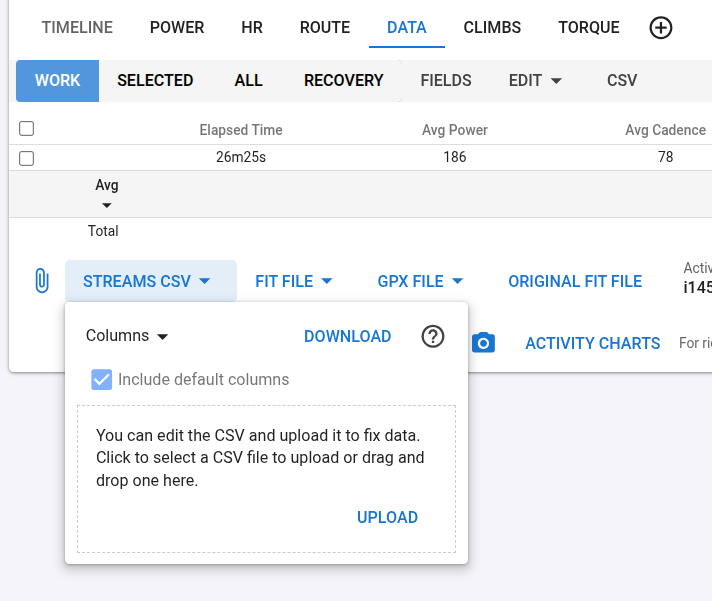

I downloaded the CSV from another activity and edited it to match what this activity would have looked like. That was easy enough, but now how do I upload it to Intervals.icu? Or convert it to a format that Strava will take? I tried converting to TCX, but when uploading to Strava it failed with the message ā€œTime information is missing from fileā€.
Hi Aaron
I wasn’t aware that importing a CSV file back is a supporter exclusive feature. Please see more details about CSV downloading and importing below:
Yeah, I noticed that too.

If you have a very similar activity, you can change the date with fitfiletools.com and then import that copy on the set date.
