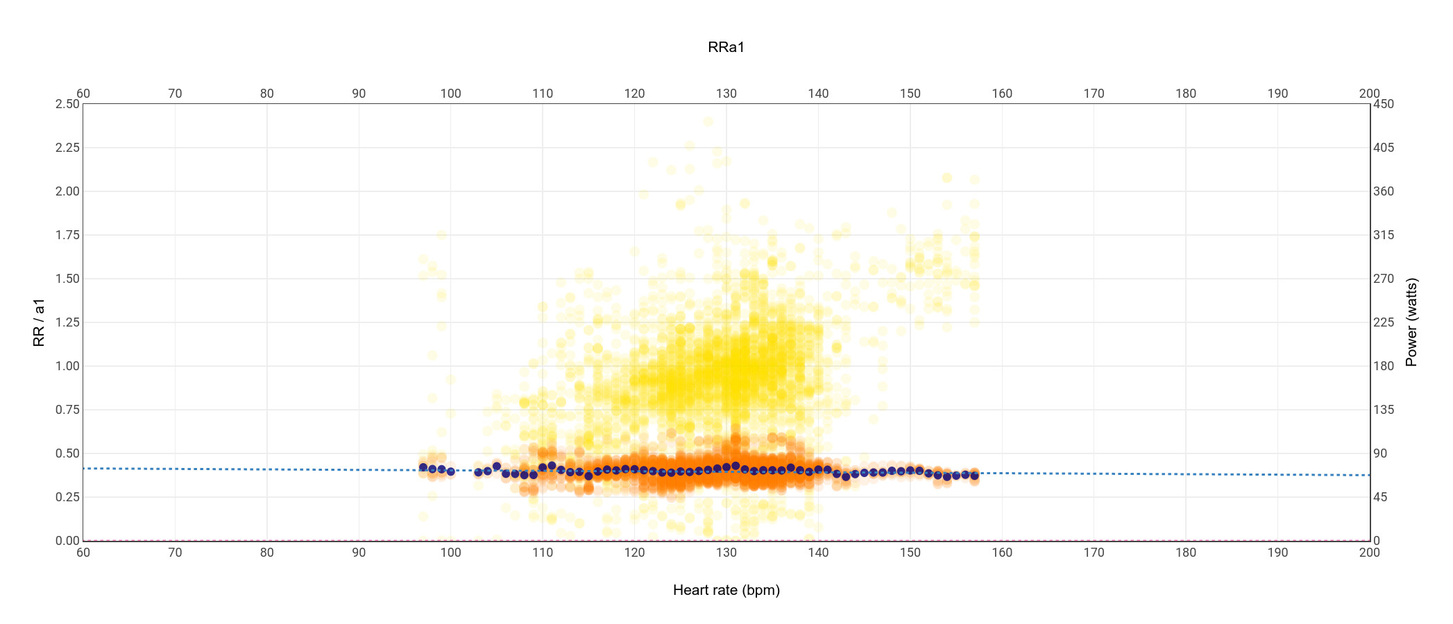

I still really wish for updated concise documentation on AlphaHRV. As interesting as it seems, the most authoritative info on it are two extremely long topics on this forum. Or at least I still can’t find anything else via Google search yet… Most places still tell me about the 0.75 number being important even though I’ve read here months ago that that’s probably outdated…
Hence my question here, wondering whether this graph indeed confirms I’ve kept an endurance pace (… OK there were two sprints when I started lagging behind on my pace partner) during an entire ~1h ride, given the very flat blue line here:
And presumably this otherwise tells me nothing since A) I didn’t follow the recommended protocol plus obviously B) I didn’t try to exceed Endurance pace.
Bruce Rogers has an excellent write up on his teams recent paper on the value of DFA a1 that corresponds to LT1. Muscle Oxygen Training: Improving the HRVT1 agreement - IJSPP 10/2024 In summary you take the readings from the start of a ramp test, when it’s easy, and minus that from 0.5. The midpoint of that value is approx the right value your’e shooting for. For most people they’ve seen it’s above 1.
As a personal test I have been ignoring power and HR and training with dfa a1 target of 1. After my sessions at a target of 1 my morning HRV measurement is stable, which is an indicator that I’ve recovered within 24 hours so is indicative of easy training.

Just had a quick look at the paper and on my data on my most recent ramp my highest was 1.46 so I my first threshold should be at 0.98 (mid way between 1.46 and 0.5) so effectively 1.
So are ye starting these ramps at really low watts in order to find the highest DFA a1 value? Say like < 30% FTP?
The HRVT1c custom value was defined as the midpoint between the maximal DFA a1 (Max DFA a1) value seen in the early portion of the ramp incremental and 0.5. This maximal value was always below 3 SD from the running 45 second local mean value. For example, if the maximal value during the early ramp incremental portion was 1.5, the corresponding V̇O2/HR HRVT1c was based on a DFA = 1.0 (midway between 1.5 and 0.5) as seen in Figure 1.
I get that, but in order to find the maximal, you surely need to be riding very low watts to start off?
Yep - I can’t see wattage reported but if you look at the HR it’s only 99-109 bpm
