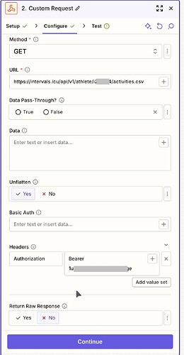

Hi everyone,
I’m trying to set up a Zapier automation to download my activities from Intervals.icu, but I’m running into issues — I believe the problem is related to authentication.
Could someone help me with the correct webhook settings?
• Should I use GET or Custom Request in Zapier?
• How should I configure the authentication correctly (API key or other method)?
Any help or example setups would be greatly appreciated!
Please be moer specific about your issues.
Could just be the fact that Intervals has your activities from Strava in which case Intervals is not allowed to forward them through the API.

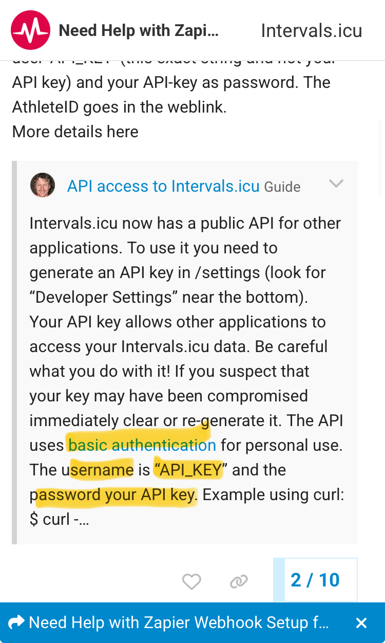

If authentication is your issue, use GET with user ‘API_KEY’ (this exact string and not your API key) and your API-key as password. The AthleteID goes in the weblink.
More details here

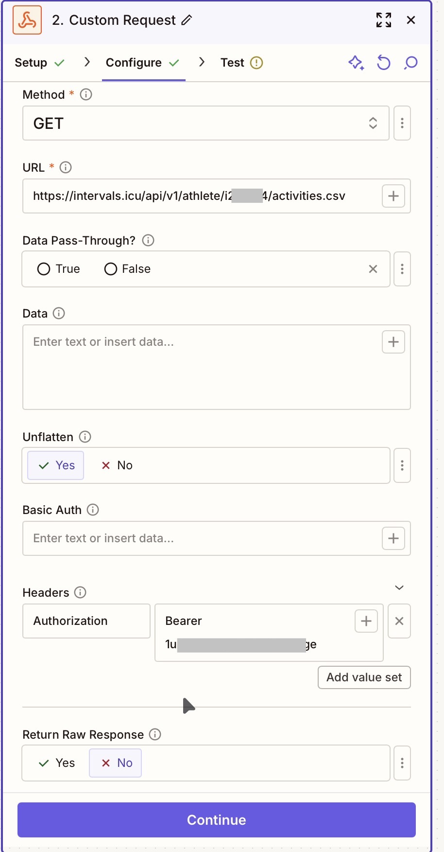

Here’s two configurations that I have tried with out success.

I have absolutely no experience with Zapier but looking at the screenshots, I’m making some wild guesses regarding what exactly you want to achieve.
The example in your first screenshot should work but will only give you a list of all your activities with basic information.

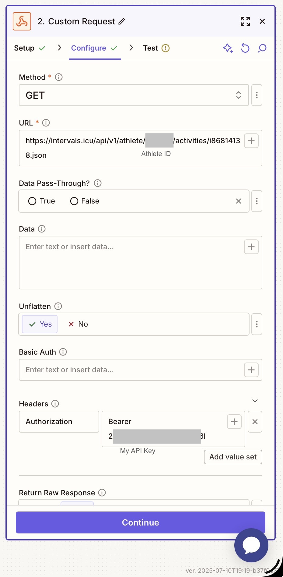

The second one will probably not work. That’s a request to download the full activity but it has the wrong authentication mode.

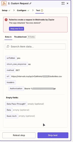

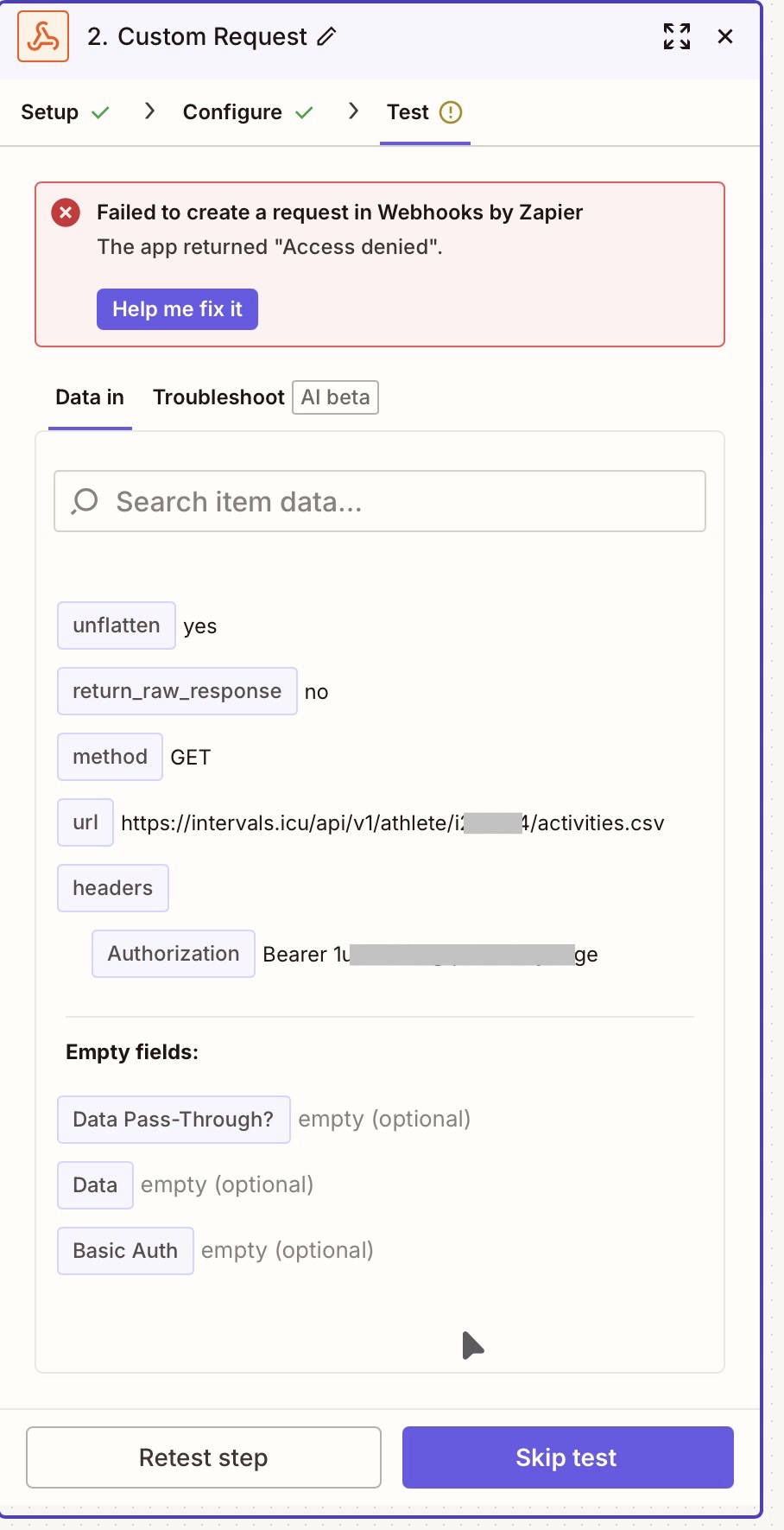

I got “access denied” with this configuration.
Not sure did I configured everything correctly?
Don’t use Bearer! use basic authentication as in your first screenshot.
I got “bad message 414” error with this conf.
Do you actually have any idea what you’re doing?
For this type of request you need to give the activity identifier. Not the csv list of activities.
You still haven’t told us what you’re actually after. You want a list of activities or you want a copy of all your Fit files?

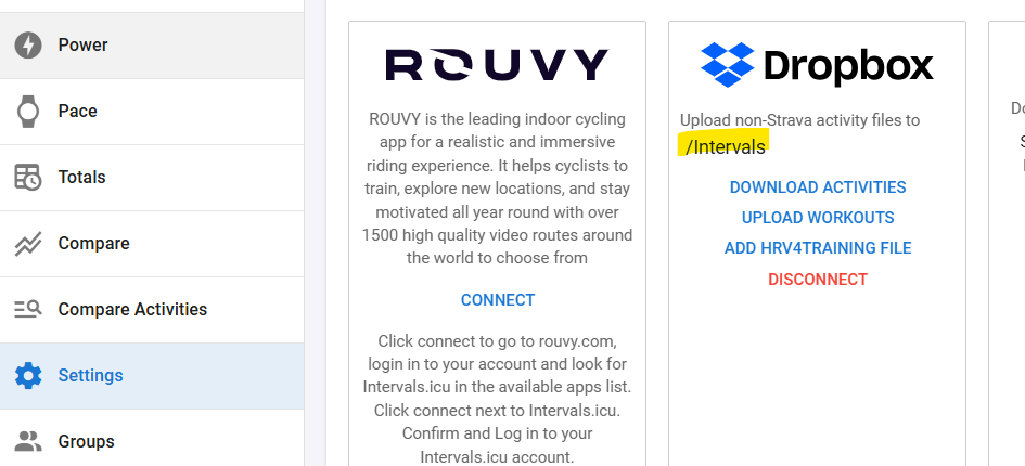

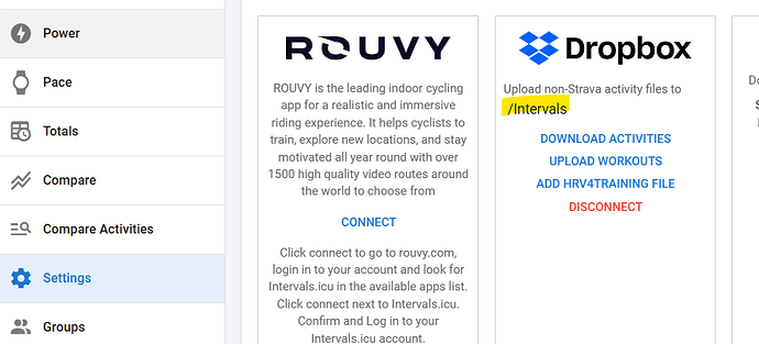

A copy of all your FIT files is easy to get if you set up dropbox.
This will copy a FIT to a dropbox folder for every incoming activity.

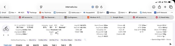

This is ChatGPT analysis from my last ride.
  1. Workout Overview
This was a fast-paced, structured ride with moderate elevation (258 m), including threshold intervals and active recovery. Duration was 1:19:43, covering 38.1 km at an average speed of 28.6 km/h. Average power was 205 W, and Normalized Power (NP) was 226 W — indicating a solid, steady effort. Average heart rate was 160 bpm, with a max of 182 bpm, placing the ride mainly in your tempo and threshold zones.
  1. Summary
This session had a clear training effect with an Intensity Factor (IF) of 0.82 and a TSS of 89, which qualifies it as a productive threshold workout. NP of 226 W equals 82 % of your FTP (276 W), which is well within the sweet spot for aerobic development. Average power (205 W = 74 % FTP) confirms solid base intensity. Heart rate data supports this: avg HR 160 bpm (≈87 % of max), peaking at 182 bpm, just below your anaerobic threshold.
