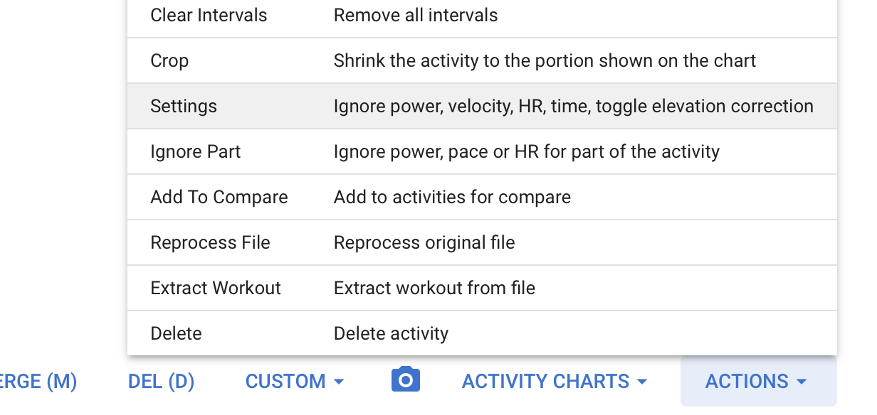

If you want to see ELAPSED TIME, then at the bottom of an activity, select Actions > Settings

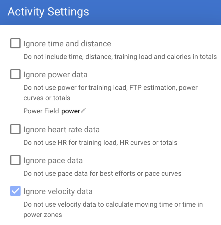

and then enable “Ignore velocity data” option as shown below:
With that setting Intervals will show total elapsed time, again its basically the same as Strava Elapsed Time and WKO elapsedtime.
