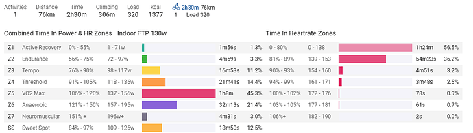

I just did my third ride on the indoor trainer and have never seen my power data before. Now I just finished a ride where I wanted to make a low effort, endurance miles. When I look at the HR data this seems to be ok, this was my main indicator during the ride as well. (As I have no clue yet what my power output should be at low intensity) The Power data shows a different story… according to the power outputs this was a HIIT training, which is strange as my HR avg is under 140. Something seems off.
What should I follow?

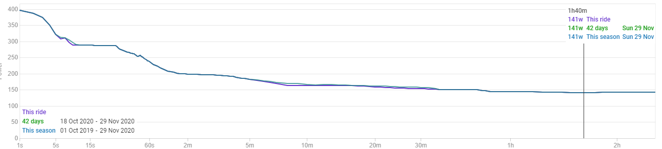

This is the curve, at 20m it reads 159W
I didn’t look at the power numbers before, but if you can produce Z5/6 Watts at recovery HR, something is off.
I’d say your FTP is set too low - you say Zwift set it, but that was probably a free ride.
You can do a proper FTP test to get a number. I’m guessing you never did that?

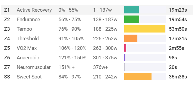

I also have a problem with this that the power and pulse zones do not match. It’s possible that my FTP is a bit too low, though I don’t think so. Interestingly, Aerobic decoupling is 4% for almost two-hour training.
Power
Now the question is to train for power or pulse?

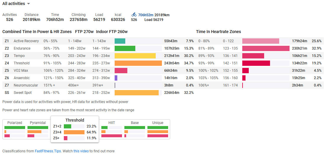

This is not to say your FTP is or is not off - just stating that mine is fine, but my numbers do not line up either :sunglasses:
:open_mouth: :open_mouth: Where’s your Z1/Z2?
Well, the numbers in HR data are 25.6% in Z1 and another 32.9 in Z2, total almost 60% in Z1+2. Which is close to the underlying question in my post. If he (or me for that matter) would ride without power meter the time in the low HR zones would be a good enough indicator for ‘base’ training but when looking at the power meter data it leads to a different conclusion.
What is the better parameter, watts or heart rate? And why?
