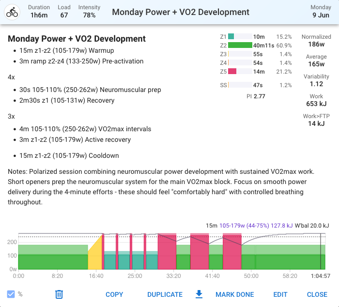

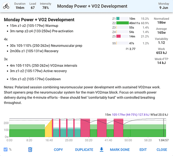

Hey, @Marc! You got me started here, and I don’t know where to stop anymore…
I’ve added some more tools to intervals-mcp-server. Check this out:
Hey, coach! I need a new workout for today. Make sure you use all tools in the Intervals.icu MCP that you deem necessary. To properly format the workout, check get_workout_format_examples for samples. Act like a mix of Joe Friel, Dr. Stephen Seiler, and Dr. Andrew Coggan.
I’ll help you create a workout for today! Let me first get the current date and check the workout format examples, then look at your recent training to design something appropriate.
  • get_current_date_and_time_info
  • get_workout_format_examples
Now let me check your recent activities and current fitness profile to design an appropriate workout:
  • get_activities
Now let me check your wellness data to see how you’re feeling today:
  • get_wellness_data
Let me also check your athlete profile to understand your current power zones and training levels:
  • get_athlete
Perfect! Now I have all the information I need to create an excellent workout for you. Let me analyze your situation:
Current Training Analysis:
  • CTL (Fitness): 79.5 - solid base fitness
  • ATL (Fatigue): 67.9 - moderate fatigue, recovered from yesterday’s ride+run combo
  • Recent Training: Big weekend (126km race on June 1st), then active recovery/base work
  • Yesterday: Quality aerobic session (90 TSS ride) + sprint run session (69 TSS)
  • Recovery markers: HRV 70, RHR 41 (good), sleep quality decent but short (6.7h)
  • Current FTP: 239W, zones well established
Training Philosophy (Friel/Seiler/Coggan approach):
  • Post-weekend quality work, you need polarized intensity today
  • Yesterday was moderate intensity - today should be either easy aerobic OR high intensity
  • Given your good recovery markers and solid CTL, this is perfect for VO2max development
  • Monday is ideal for neuromuscular power + aerobic capacity
Let me create a workout that combines Coggan’s structured intervals with Seiler’s polarization principles:Perfect! Your workout is now loaded and ready to go! :man_biking::high_voltage:
Workout Breakdown - “Monday Power + VO2 Development”
Total Time: ~57 minutes | Expected TSS: ~85-95
The Science Behind This Session:
Friel’s Periodization: You’re in a maintenance/sharpening phase post-race, so we’re maintaining your VO2max while adding neuromuscular touches.
Seiler’s Polarization: Yesterday was Zone 2/3 work - today we go full polarized with easy warmup/recovery and hard VO2max efforts (nothing in between!).
Coggan’s Power Zones: Using your 239W FTP, the 105-110% efforts hit 251-263W - right in your VO2max sweet spot for maximum aerobic power development.
Execution Strategy:
Neuromuscular Openers (30s @ 105-110%):
  • Prime your fast-twitch fibers
  • Focus on smooth, controlled power
  • These aren’t all-out sprints - think “opening the taps”
VO2max Main Set (4m @ 105-110%):
  • Target 251-263W sustained
  • Breathing should be controlled but deep
  • Stay seated, maintain 90+ rpm
  • Each interval should feel “comfortably hard” - you should finish thinking “I could do one more”
Recovery is SACRED:
  • Keep it truly easy (131-179W)
  • Use this time to prepare mentally for the next effort
This session perfectly balances your current fitness level with progressive overload while respecting your recovery state. The polarized approach ensures you’re not accumulating junk miles in the middle zones.
Ready to crush it? :flexed_biceps:
Workout created:
# Monday Power + VO2 Development
- 15m z1-z2 Warmup
- 3m ramp z2-z4 Pre-activation
4x
- 30s 105-110% Neuromuscular prep
- 2m30s z1 Recovery
3x
- 4m 105-110% VO2max intervals
- 3m z1-z2 Active recovery
- 15m z1-z2 Cooldown
> Notes: Polarized session combining neuromuscular power development with sustained VO2max work. Short openers prep the neuromuscular system for the main VO2max block. Focus on smooth power delivery during the 4-minute efforts - these should feel "comfortably hard" with controlled breathing throughout.
The changes can be found on my fork (GitHub - scorphus/intervals-mcp-server: Model Context Protocol (MCP) server for connecting Claude with the Intervals.icu API · GitHub) and a PR can be created if you want to review them.
For sure, it all needs a bit of tweaking — e.g. get_athlete — but I hope you like the new tools! If you have any specific preferences or adjustments, let me know and I can refine it further. This message is actually to start a discussion on that.
Happy training! :man_biking::dashing_away:
