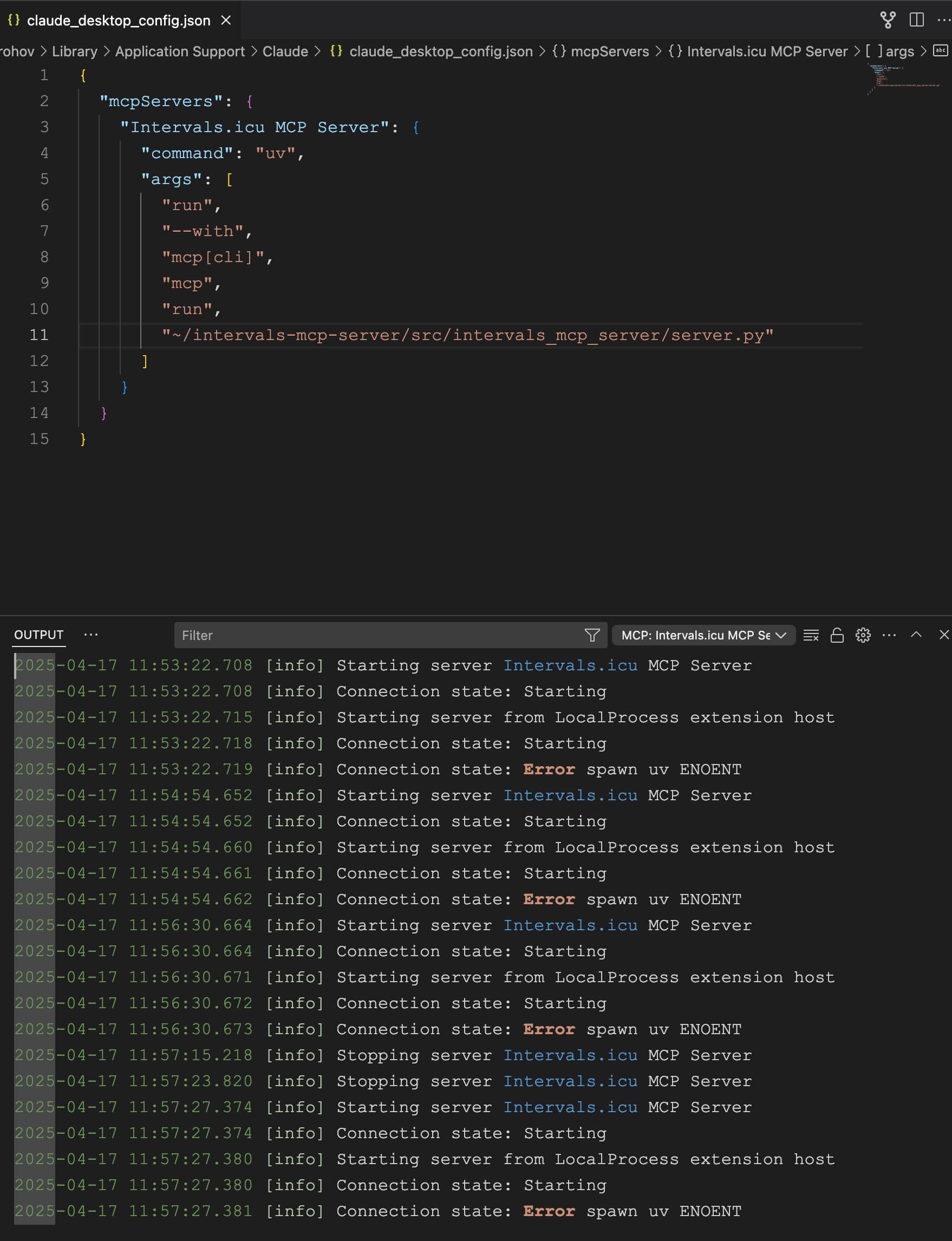

I have this error
2025-04-17 11:57:27.374 [info] Connection state: Starting
2025-04-17 11:57:27.380 [info] Starting server from LocalProcess extension host
2025-04-17 11:57:27.380 [info] Connection state: Starting
2025-04-17 11:57:27.381 [info] Connection state: Error spawn uv ENOENT
I added a manifest file: adds missing manifest by mvilanova · Pull Request #6 · mvilanova/intervals-mcp-server · GitHub. Can you try again and let me know if you’re still having the same issue?
Fixed the clone url as well in fixes repo clone url by mvilanova · Pull Request #7 · mvilanova/intervals-mcp-server · GitHub. Thanks for letting me know!
This looks like a connectivity related issue. Could you share more about the environment where you’re running the code?
Yes, It was a problem with uv installation. I did brew install uv and problem is gone

      https://hatch.pypa.io/latest/config/build/
      As an example, if you intend to ship a directory named `foo` that resides within a `src` directory located at
      the root of your project, you can define the following:
      [tool.hatch.build.targets.wheel]
      packages = ["src/foo"]
      hint: This usually indicates a problem with the package or the build environment.
To fix this and to get the dependencies to install, I added the following lines to pyproject.toml per Claude’s recommendations:
packages = ["src/intervals_mcp_server"]
