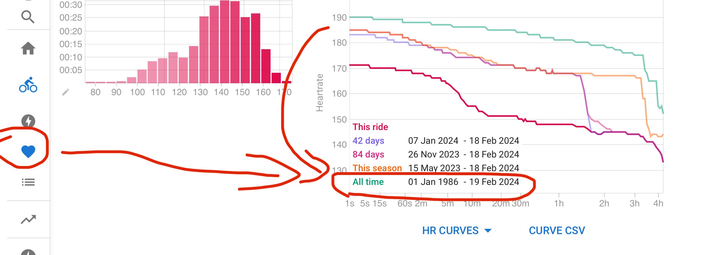

You can also see your all time max on the HR chart, in every activity.

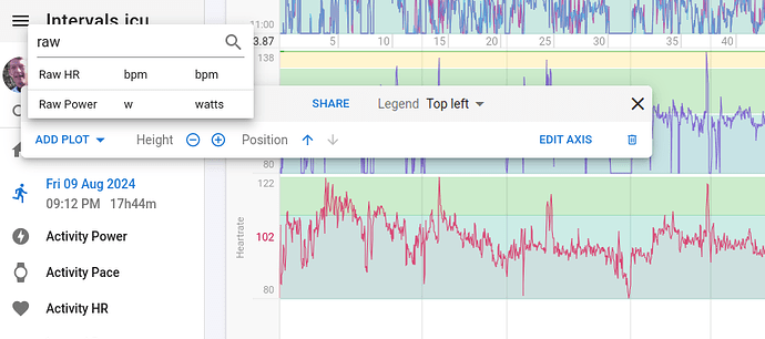

Is raw-hr actual hr ?
I can’t find raw-hr on the custom chart tool
J
It´s a std chart. Click on the + icon and add it.
It´s the unmodified stream from your device.

Hello! I am a new member as of earlier today and have successfully loaded 12 years of data. I’m finding my way around fairly well, but cannot find “Raw HR” anywhere. It is not available to add a plot to a new chart and I cannot add it as a column on the home table.

On the activity page, go to the bottom and click on ‘Charts’, then on the +Chart.
In the popup dialog, click on Add Plot and search for RAW to brin up this:
Select Raw HR and you will have an extra chart with the RAW HR.

Success! Many thanks!

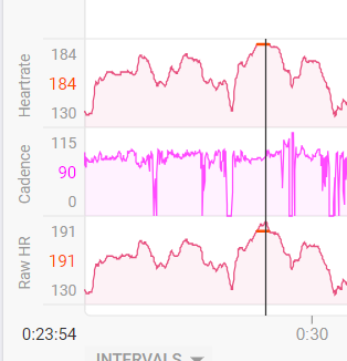

So I’m assuming then that because the HR drops off so quick from 191 that this is a spike
What is your maxHR set to, on the Settings page?
It could be a spike, and it could also be a max reading.
It depends what you were doing at this point in time. Is there speed available if you don’t have power.
No speed available, my Garmin decided to update and turn off using GPS right before the start.
I was climbing Edinburgh drive at the time.
Max HR was set to 184, that why you can see the smooth red line as intervals detected it as a spike.
So it could be a genuine max effort?
Was this the Argus, given you said Edinburgh drive?
