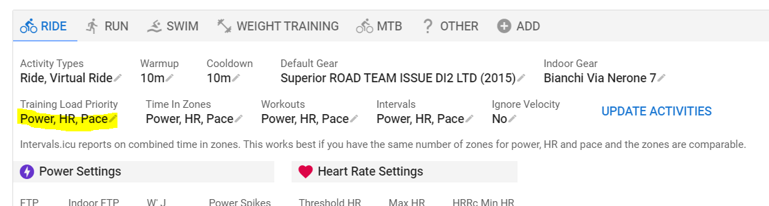

In Intervals, you can select what number you want to use for load calculation, power, HR or pace.
Power load is referenced to FTP, HR load to LTHR, pace load to Threshold Pace.
If your routine is walk and bike in the lower intensity zones for health reasons, you could set both Ride and Run(walk) to prioritize HR as load calculation and you will get more consistent numbers when comparing the loads between activities.
But if you do HIT work on the bike, you will be better of by using Power for the bike and dialing in your zones so that HR and Power zones are better matching.
To know which parameter is used for your activities, check the settings page and the Load calculation setting for each category. Intervals will use the first one on that list that is available in your activity file to calculate load.
